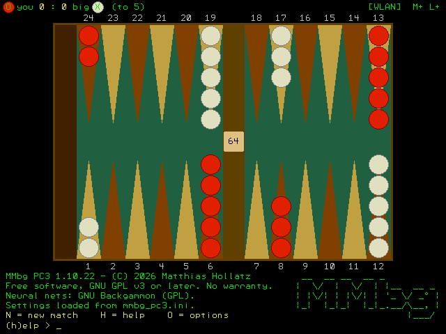

Hello to all PC3 owners!
I'd like to introduce MMbg PC3 - a complete backgammon program for the Pico Computer 3.
Features
- match play 1 to 15 points with doubling cube and Crawford rule
- uses the neural nets of GNU Backgammon: the "big" engine plays at about gnubg "Expert" level (0-ply) and wins ~47 % of 5-point matches against gnubg "World class" (2-ply), measured over 1236 matches
- written completely in MMBasic - no CSUB needed
- HDMI graphics (MODE 3) with smooth animation, plus an ASCII board on the serial terminal
- keyboard or USB mouse, multi-level undo, auto save and resume
- .mat export and GNUbg IDs for analysis in gnubg, optional sound
- for tinkerers: gnubg on a PC as opponent over WLAN, overnight test runs
Requirements
PC3 with firmware PicoMitePC3 V7.00.00 RC2 or later.
Installation
Unzip the ZIP onto the SD card, then:
CHDIR "B:/mmbg"
LOAD "mmbg_pc3.bas", C
RUN
The manual (English and German PDF) is included.
The version for the PicoCalc (PiCa) will follow ...
Have fun playing and testing! Please report all bugs here.
