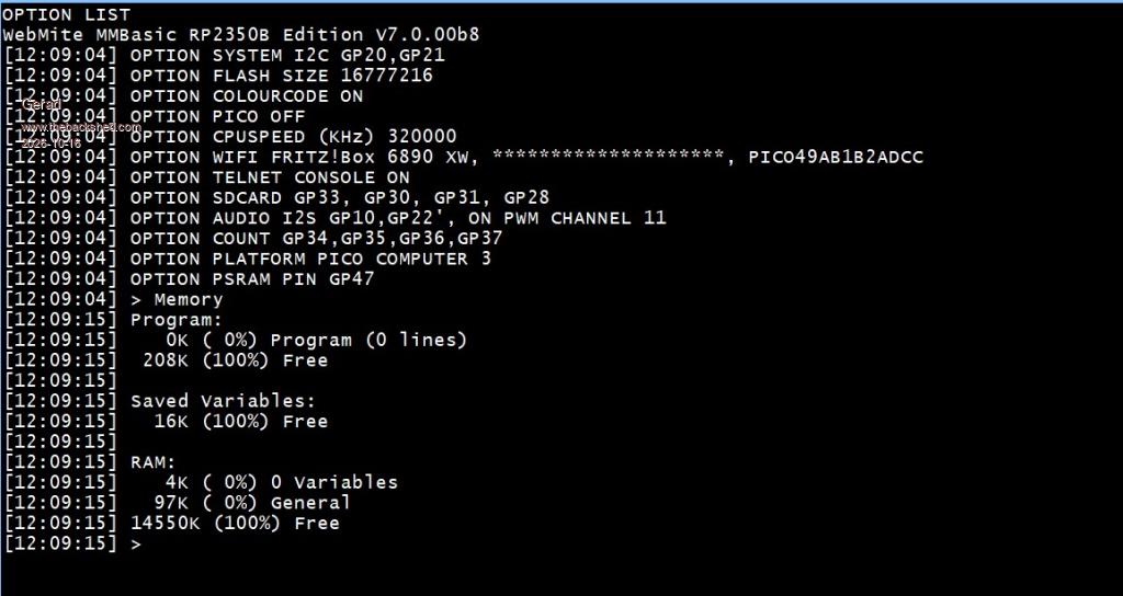

Posted: 09:54pm 16 Oct 2026
@Peter
I THINK YOU CAN NEVER HAVE ENOUGH “RAM.”
And paying 5€ more for 16MB isn't “super expensive”—it's okay.
What do you think of the 16MB fix? The fix was created by “Claude”
PicoMite / WebMite 7.00.00RC2 - fixes for the RP2350 PSRAM builds

Posts: 12051
Posted: 10:47pm 16 Oct 2026
The change is trivial and wastes 8K of precious real memory for every build that doesn't have a 16Mb PSRAM chip which is precisely why I won't do it. To do it properly the psram map has itself to be in psram which changes the 6MB and again affects everyone
