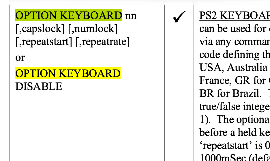

Peter,
I have a similar keyboard, but it's connected via USB (Pico 3 computer).
Is there a way to set it so that NumLock is NOT enabled when the computer is turned on?
Cheers Martin
'no comment
Posts: 12051
Posted: 06:08pm 09 Oct 2026
OPTION KEYBOARD xx,0,0 should do the trick - missing from the manual for some reason

well that is it.
I guessed to be the only person with "num lock" on at startup...
what is the meaning of the further parameters?

I found it in the manual...

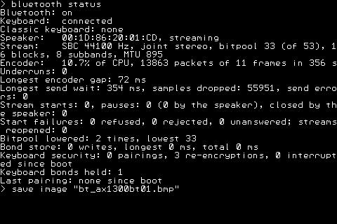

AXIS AX1801BT Car radio - AUDIO INTERRUPTED - Click and short pause in audio for approx 0.5 sec every 3 seconds
AXIS AX1300BT Car radio - AUDIO INTERRUPTED - Clicks and stutter in audio at random times.

I have tried to catch a Blutooth Status report at the exact moment the AX1801BT stereo glitched but so far no amount of tries shows a significantly different outcome to those posted previously.

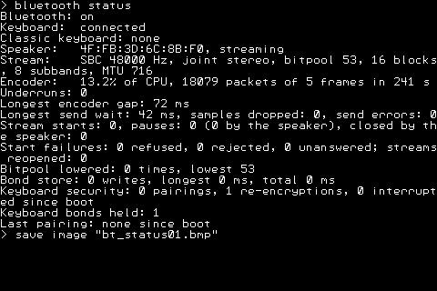

- **AXIS AX1801BT:** the board now offers the speaker only 44.1 kHz. The
 radio was choosing 48 kHz, and we suspect that is behind the gap every 3
 seconds.

2. `BLUETOOTH STATUS`: the `Stream:` line should now start
  `SBC 44100 Hz`. It said 48000 before.
3. Play music from a file for at least 3 minutes. Is the gap every 3
  seconds gone, still there, or different?
4. Send the `BLUETOOTH STATUS` listing from straight after the music.
## Test 4: the AXIS AX1300BT
1. Play music from a file for at least 3 minutes, as before. Are the
  stutters the same, better or worse?
2. Send the `BLUETOOTH STATUS` listing from straight after the music.
