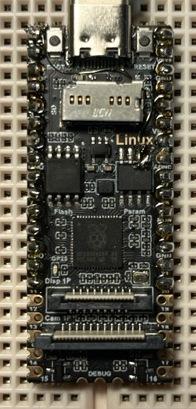

Hi all,
i have just received this nice little RP2350A board from China (alixexpress) called "Spotpear RP2350A-Linux-Pro Board" for 11GBP (so under 15USD).
First impressions are very positive, it has the "normal" Pico formactor but adds a SDCard slot and 8MB PSRAM.
Seems to run fine @384Mhz
> option list
PicoMite MMBasic RP2350A V7.0.00b6
OPTION FLASH SIZE 16777216
OPTION COLOURCODE ON
OPTION CASE UPPER
OPTION PICO OFF
OPTION CPUSPEED (KHz) 384000
OPTION DISPLAY 36, 100
OPTION SDCARD GP21, GP22, GP23, GP20
OPTION COMPILE ON
OPTION PSRAM PIN GP19

docs and schematics are here: docs
I have only tested the "basic" version of mmbasic, no hdmi/vga/usb testing done yet.
Will do some more testing but I really like this board so far.

Nice board. Unfortunate choice of pin for PSRAM select though. :(  Perhaps a mod might be possible to change it to GP0.

Bodge done, PSRAM CS is now on GP0. A bit ugly but I'm happy with it
Will add some glue to keep the bodge wire fixed. And I kept GP12-19 free for a HDMI adapter.
Edited 2026-10-10 22:16 by fred777
Posts: 9234
Posted: 01:19pm 10 Oct 2026
Exactly how I pictured it, but I'd have used yellow wire as I have some and I suspect the electrons like bright colours. :)
Just one point, did you preserve the pullup? If not you may find that you need one.

No, the pin goes straight to GP0, I did the same with this board, and it didn't seem to matter. Perhaps it could fail in a noisy EMC environment.

  fred777 said  No, the pin goes straight to GP0, I did the same with this board, and it didn't seem to matter. Perhaps it could fail in a noisy EMC environment.
Without pullup it may work sometimes, but it is not reliable. There are phases of operation (e.g. booting up) where the CS pin of the PSRAM is floating. Believe me, I made the same error. Ended up that I couldn't even flash a new firmware anymore. Installed the pullup and all issues were gone.

Ok ok, another bodge
Don't even start about about how ugly this looks - I'm just glad the thing still works.
