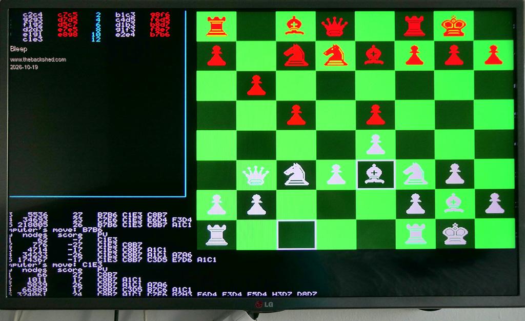

I'm supposed to be on holiday, but it's raining, so we can't go Mountain Biking, so I thought I'd finish this off.
Attached is Peters CSub version of TSCP Chess, so, playably fast, but using a 640x480 tiled VGA display, so hopefully looks nicer than the older version. Unfortunately where I am, the TV from a HDMI source, is cutting off all of the edges of the display, so I can't see the first 2 of last characters, or the top or bottom lines, which makes editing and testing a bit of a nause. However hopefully this is a reasonably working version, if anyone wants to tidy it up, feel free, there are problems with undo, as far as the display of moves so far, but it does work.
I have only tested on a 2350 HDMIUSB. There is an 'auto' command where the computer plays itself, 'help' command gives a list of available commands.
Regards Kevin.
chesscsubvga.zip
Edited 2026-10-19 01:10 by Bleep
Bleep
Joined: 09/01/2022
Posts: 863
Posted: 03:19pm 18 Oct 2026
The version I uploaded yesterday had an error, it was loading the Sprite bitmaps as well as the new Tiles, and so would fail as I didn't supply the sprites, which are no longer used.
I have also made the default Search Depth 16 and the Search Time 1 minute, my understanding is that it will use up to a minute for the computers move, and as the number of pieces goes down the search depth will ultimately go up to 16, if there is enough time. This might make the end game better.
you can set your own SD and ST if you want from the command line.
I've also managed to do a photo, bear in mind the TV I have is cutting off all the edges.
Regards Kevin.
chesscsubvga.zip
Posts: 6195
Posted: 04:42pm 18 Oct 2026
Looking good. To bad your TV does not show all. No way to force it to show all. I had one monitor (VGA) that behaard similar, and in the setup menu I could not adjust, but when I connected VGA cable when pico showed a full (whip) screen it adjusted correct.
I do not know HDMI setup functions. But what happens when you select OPTION resolution 640,252000
Bleep
Joined: 09/01/2022
Posts: 863
Posted: 03:17pm 19 Oct 2026
Hi Harm,
It's a hotel tv, so not great, I've tried various settings but no improvement, it's not that they are off the edges of the screen, they are just not there at all, if I reduce the picture size the image is the same, even though there is screen area available :-( @ home it's fine, hopefully!  Changing CPU speed also has no effect.
Regards Kevin.

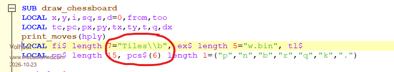

Posts: 6195
Posted: 12:23pm 23 Oct 2026
Hi Kevin,
After a small bugfix, it runs on 2040 VGA (V7.00.00rc3).
Replace the double "\\" with "\"
At top of screen there is still a residual of copyright text "MMBasic Ceptimus". But that is outside the visible area at your hotel room TV I guess.
P.S. I actually like this version. I used the dual pico version, but in auto mode it is so fast I cannot keep up with even understanding what it does. The full MMBasic version is so slow (several minutes per move) you loose interest. But this version with the CSUB is the right speed. I can follow the machine thinking, and learn from it (and I do not need another pico wired in). Maybe this version with 320x240 screen could even work in the Game*Mite. But it would require a different way of entering moves (a virtual keyboard would cover the playfield to much, so it would need to be cursor controlled). And how to control play depth, etc... A whole new development. I realized the same now I am busy modifying MaxiTrek to work on Game*Mite. That game is also text controlled. And Tom (thwill) designed controls for Petscii Robots, he also suffered with the limited keyboard of the Game*Mite. In that respect a PicoCalc is a lot better.
