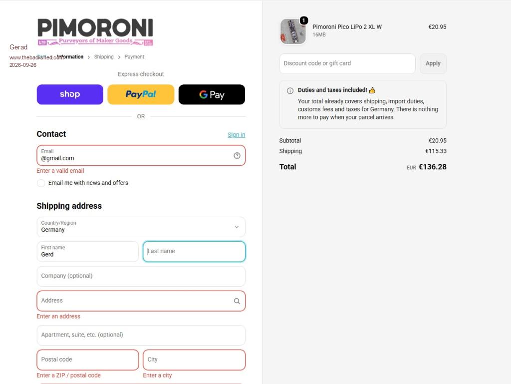

PIMORONI :
Because of the crazy prices, I had to cancel my order
ville56
Joined: 08/06/2022
Location: Austria
Posts: 624
Posted: 12:14pm 26 Sep 2026
Gerad,
I can't believe the shipping cost. I had 2 "pico plus 2W" plus some other minor stuff delivered about 4 weeks ago to Austria. The shipping was about 27€ IIRC. The cost for shipping to germany should be essentially the same. There was an additional bill from the shipping company of abt 10€ for customs a few days later. Did use PayPal for settlement.

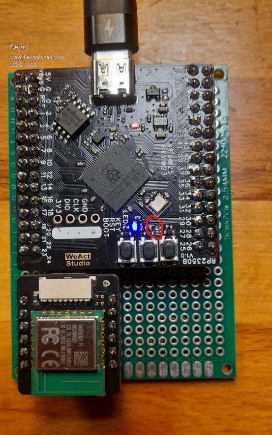

Posted: 06:53pm 02 Oct 2026
Hi everyone,
If you need a 2350B with Wi-Fi: Get a WeAct Studio (check AliExpress) and the RM2 Wi-Fi module. Connect the GP23, GP24, GP25, and GP29 to the RM2. To ensure the board runs without a reset, you’ll need to remove the zero-ohm resistor on the WeAct board (see photo)—and you’ll have an affordable 2350B with Wi-Fi. It works with WebMite MMBasic RP2350B Edition V6.04.00RC1
