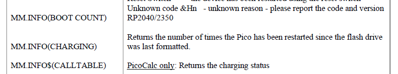

Page 111 MM.Info
MM.Info(BOOT COUNT) is out of alignment with it's description.
Caused by the addition of Brownout as a reason for MM.INFO(BOOT)
It affects the rest of that page.
Posts: 11934
Posted: 09:57pm 21 Sep 2026
Thanks - done and updated in the release
