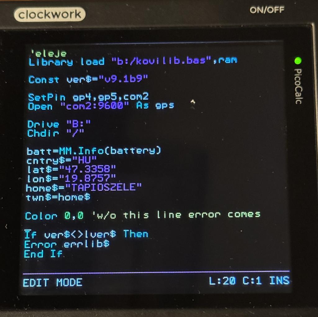

I simply put a line COLOR 0,0 before first IF in the main program and error disappeared.
Library Save is ok.
G@bor
terekgabor
Joined: 02/01/2026
Location: Hungary
Posts: 140
Posted: 07:58pm 22 Sep 2026
Peter!
I reduced the main program and library as the followings:
Library: (mylib.bas)
Dim cnvrt conv(9)
Type cnvrt
R1 as float
R2 as float
Bstr as string
Rstr as string
End type
Main program:
Library load “b:/mylib.bas”,ram
If ver$=“” then
End if
The content of the if statement doesn’t matter. Can be anything.
Error Invalid request of 0 bytes comes.
If I put for example Color 0,0 before If error disappears.
Color 0,0
If ver$=“” then
End if
Error comes back if I delete or comment out Color line:
‘Color 0,0
If ver$=“” then
End if
G@bor

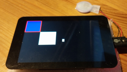

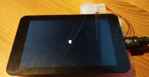

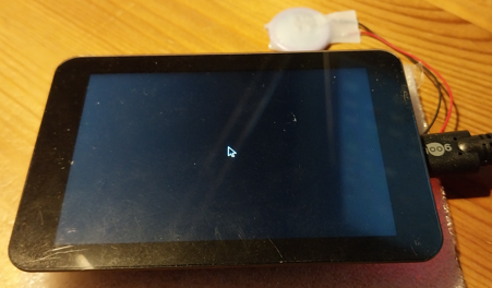

GUI cursor on/off – when I set the cursor to off, a light-colored box remains.
> option list
PicoMite MMBasic RP2350B V6.04.00RC0
OPTION LCD SPI GP18,GP19,GP16
OPTION SYSTEM I2C GP34,GP35
OPTION FLASH SIZE 16777216
OPTION COLOURCODE ON
OPTION PICO OFF
OPTION CPUSPEED (KHz) 200000
OPTION LCDPANEL ST7796S, LANDSCAPE,GP20,GP23,GP21,GP22,INVERT
OPTION TOUCH FT6336 GP25,GP24,,50
GUI CALIBRATE 1, 6, 312, 10243, -9961
OPTION GUI CONTROLS 50
OPTION SDCARD GP31, GP26, GP27, GP28
> gui cursor on
> gui cursor off
/Peter63
Edited 2026-09-23 16:52 by Peter63
Posts: 11934
Posted: 07:24am 23 Sep 2026
What does GUI CURSOR HIDE do?
Can you blit on this screen?
BOX 0,0,100,100,5,RGB(RED),RGB(BLUE)
BLIT 0,0,100,100,100,100
If that doesn't work your screen doesn't support reading from the framebuffer and the cursor can never work
Edited 2026-09-23 17:32 by matherp
Peter63
Joined: 28/07/2017
Location: Sweden
Posts: 214
Posted: 07:30am 23 Sep 2026
  Quote  What does GUI CURSOR HIDE do?
tested GUI CURSOR HIDE
when I set the GUI CURSOR HIDE, a light-colored box remains.
/Peter63
Posts: 11934
Posted: 07:32am 23 Sep 2026
See my update to the previous post
Peter63
Joined: 28/07/2017
Location: Sweden
Posts: 214
Posted: 07:36am 23 Sep 2026
tested BLIT doesn't work
Edited 2026-09-23 17:40 by Peter63
Posts: 11934
Posted: 07:40am 23 Sep 2026

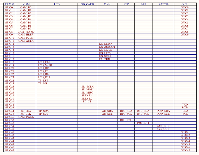

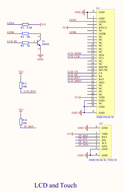

The ST7796S controller does support reading from the framebuffer. Check the schematic for your screen and that GP16 is properly connected. You may be able to modify something to get MISO working.
P.S. I tested on a ST7789_320 and the cursor commands work perfectly
Edited 2026-09-23 17:41 by matherp
