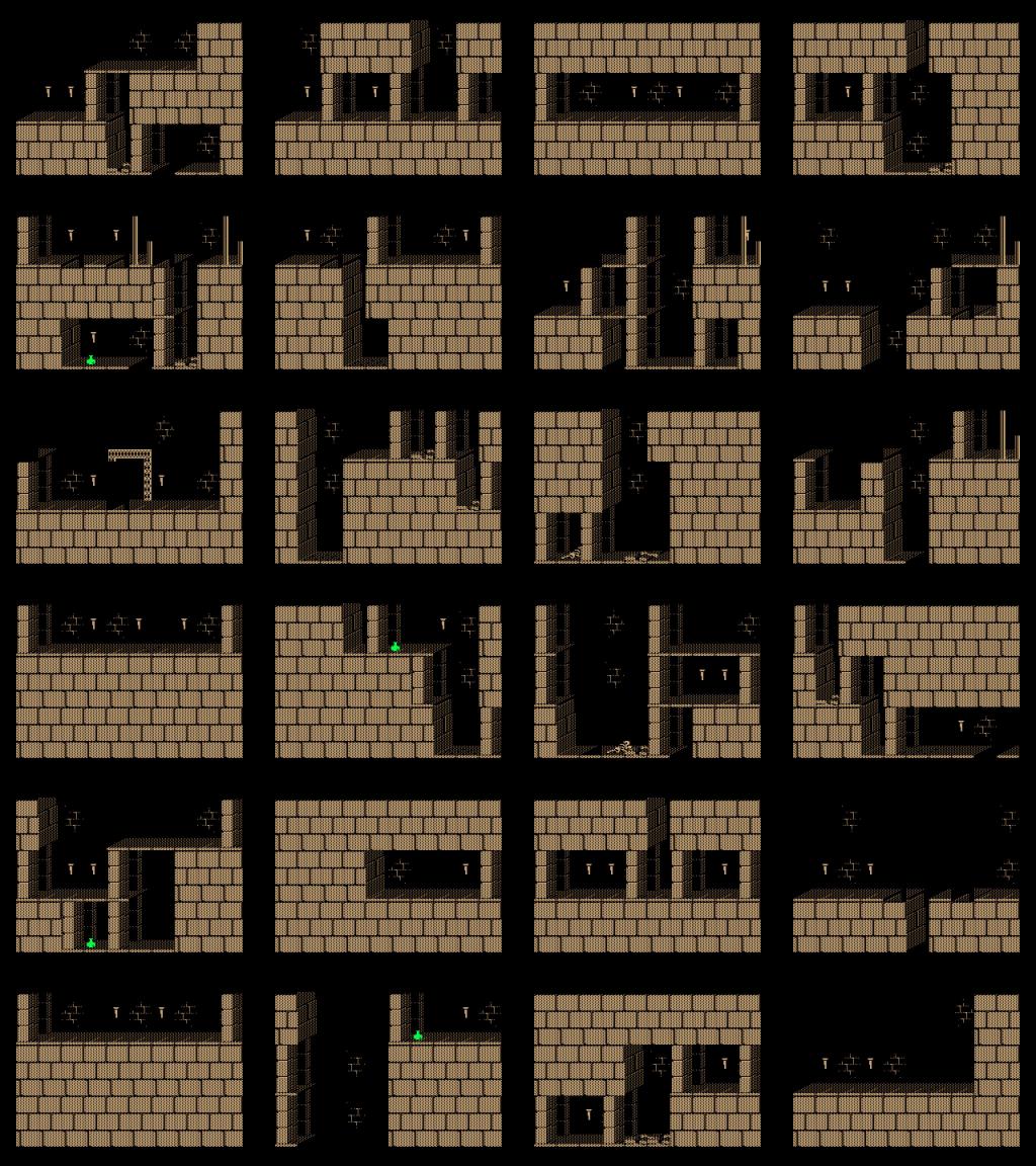

Level 1 screens

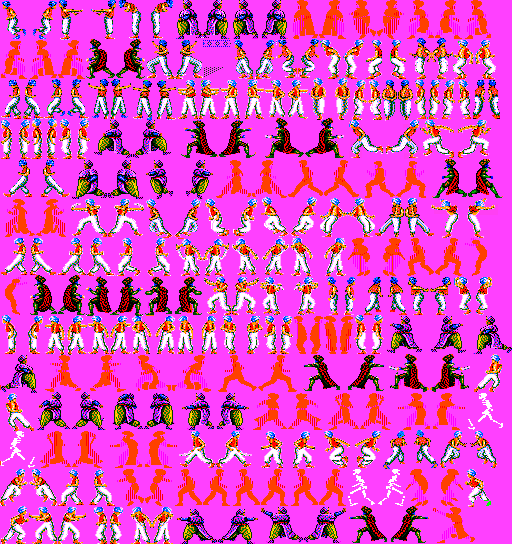

A big improvement would be to update the sprites which I think are all in one file. You would then need to look at the use of the map statement in the program. The transparent colour is currently 11 so you have the other 15 to play with.

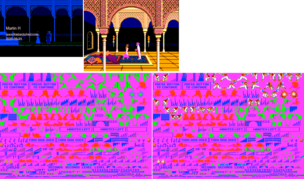

Posted: 09:27am 24 Sep 2026
One problem, among others, is that the Apple II generated some of its colors using the NTSC error, which is why some colors are stored as vertical lines in the source files. This results in only half the horizontal resolution and is difficult to convert.
Here are two examples: the Apple graphic and my adaptation:
On the left is CUTROOM.BMP from the Apple II; on the right is my version.
Below that is the sprite sheet “sheet4.bmp,” and next to it is my initial attempt to improve the sprites for RGB 121. I keep the sprites in the same position and at the same size so that no adjustments to the program code are necessary; the only thing that’s omitted is the “MAP” command. The corresponding lines can then be REMed out.
I'm using the Sega Genesis version as a guide, but I'm not just copying the images as they are.
I still have quite a bit of work ahead of me, but I'm already looking forward to the result
Martin

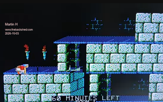

So, here's a quick update:
I've now customized about 90% of the Prince animation sprites and some parts of the environment; next up are the enemies.
The program has been modified so that it no longer executes the MAP commands.
PoPico
cheers
Martin
Edited 2026-10-03 19:34 by Martin H.

Posts: 9166
Posted: 10:00am 03 Oct 2026
I think you need a few changes to make the game very slightly different and give Ubisoft's lawyers a giggle.
Prince of Preston - The search for the Holy Beard Trimmer
Although I don't remember Preston being quite so rocky and I believe they have installed electric lighting now.  :)
(Lovely work, Martin!)
Edited 2026-10-03 20:01 by Mixtel90
Posts: 11934
Posted: 10:06am 03 Oct 2026
In my thread title I called it Prince of Pico but somehow that went missing. I think perhaps I put a quote in the line. The same happened to the thread title of V7.00.00 which should have had "Scotty: I need more power" after the colon.
Martin: looks great!
Edited 2026-10-03 20:06 by matherp
