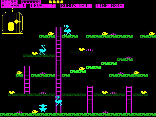

Runs using a local keyboard (USB or PS2). could be modified to use other controls. Tested on the PC3 with both HDMI and VGA builds. May work on a RP2040 (untested).
Please reports any issues with the game play (with corrections if possible)

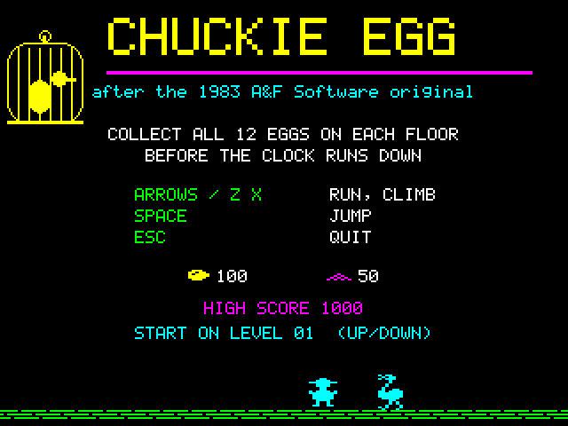

'  C H U C K I E   E G G        PicoMite MMBasic
'  after the 1983 BBC Micro game by A&F Software
'  Runs in MODE 2 (320 x 240, 16 colours) on VGA and HDMI builds.  MODE 2 is only
'  selected if the screen is not already 320 x 240.
'  Harry has to gather all twelve eggs on each floor before the clock runs
'  out while the hens patrol the girders.  Grain piles are worth points and
'  the hens stop to eat them.
'  The eight floors come round five times over, and each time the odds get
'  worse:
'    levels  1-8   the floor's own hens (3 or 4), duck still caged
'    levels  9-16  no hens at all, but the duck is loose and hunts Harry
'    levels 17-24  the hens are back, and the duck stays out with them
'    levels 25-32  five hens on every floor, plus the duck
'    levels 33-40  five hens and the duck, everything at full speed
'  Keys      Left / Right ... arrow keys, or Z and X
'            Up / Down ...... arrow keys (ladders)
'            Jump ........... SPACE
'            Quit ........... ESC
'  For testing: UP and DOWN on the title screen pick the level to start
'  on, and N during play skips straight to the next one.
