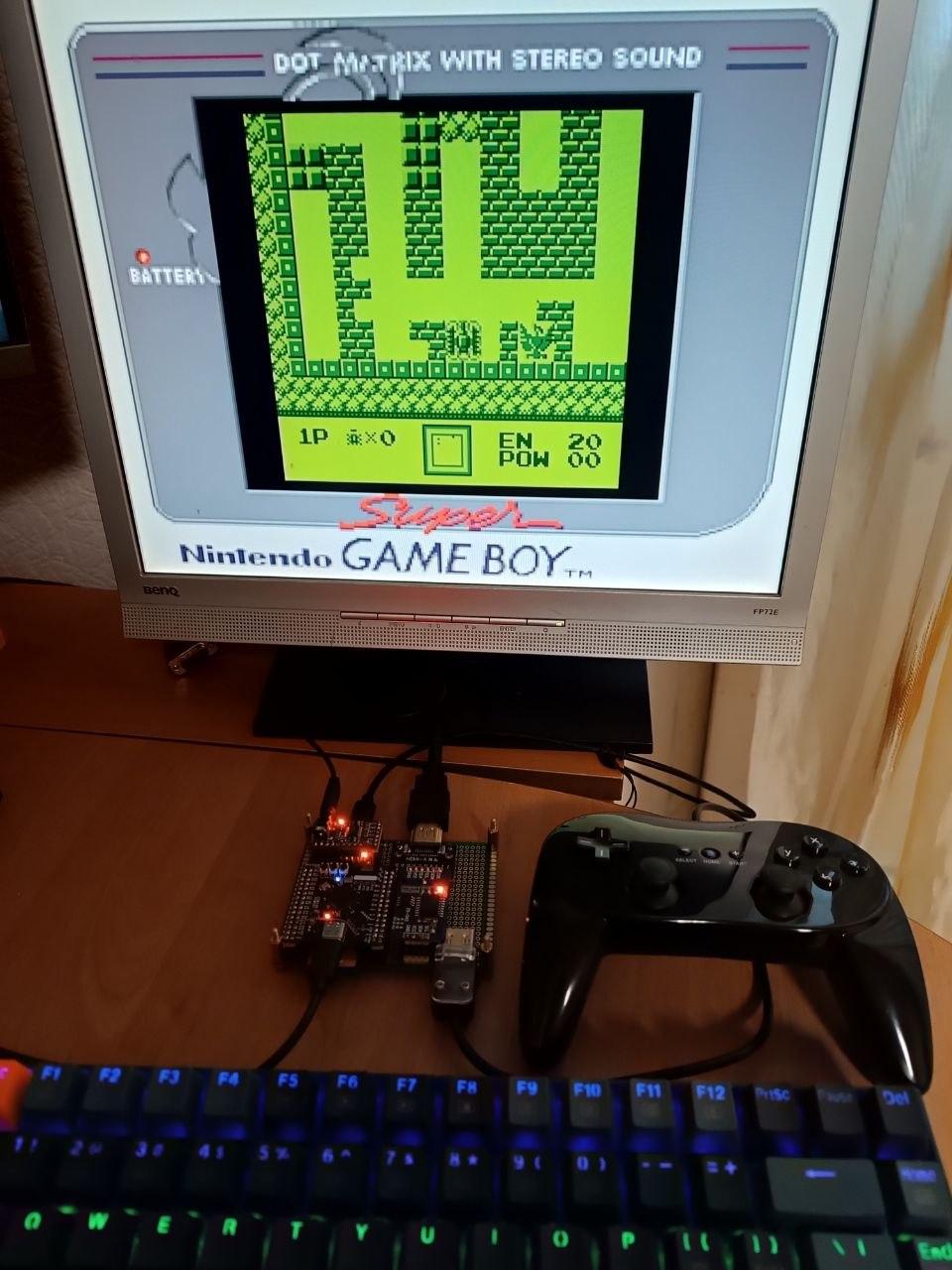

Nintendo GAME BOY & GAME BOY COLOR emulator for the PC3
PC3-PicoPeanutGB_012.zip
Video output: DVI or HDMI
Sound output: I2S or HDMI
Controls: USB keyboard or USB Gamepads, Wii classic controller,
two NES/SNES controllers
GP0 - CLOCK 1
GP1 - LATCH 1
GP2 - DATA  1
GP3 - CLOCK 2
GP4 - LATCH 2
GP5 - DATA  2
See the project's GitHub page for more information
fhoedemakers/pico-peanutGB

Of course, all these emulators worked on the RP2040, even with HDMI audio.
However, with RP2350 + PSRAM, NES game images are loaded not into flash memory, but instantly into RAM.
As for the PC3 platform, I built it on a breadboard, and now I have something to play with. So, it's just for fun.

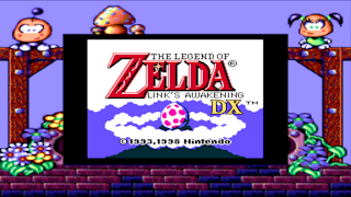

PicoPeanutGB is a Game Boy (DMG) and Game Boy Color emulator for PC3
PicoPeanutGB_v13.zip
v0.13 Release notes
A maintenance release. It brings the shared menu and support code up to date; the emulator itself is unchanged. Upgrading is only a matter of flashing the new .uf2 — your settings, saves and save states on the SD card are untouched.
