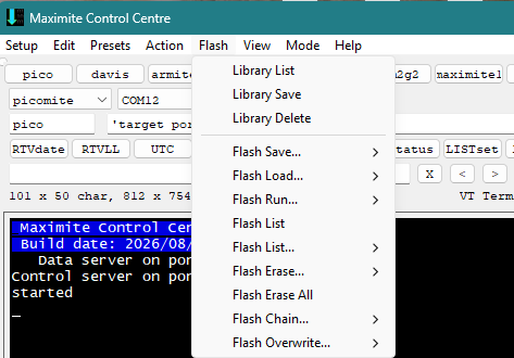

All flash commands are moved from the file manager to the MMCC menu. (Drive A: is still accessed through the file manager.)
Delete Library and delete all flash slots ask for confirmation.

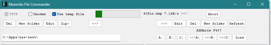

The top line:
TFTP is available on the webmite when connected via TCPIP.
Ymodem is available on some picomite variants. IF Ymodem fails to start, it will revert to Xmodem.
(TFTP and Ymodem are both much faster than Xmodem)
When transferring to a 'mite, you can choose to create a temporary file first. This is more secure and less likely to delete a valid file if the transfer fails. It does require sufficient drive space.
Transfers TO the PC always use a temporary file.
Progress indicator. It may not appear for small files. It resets to zero once the transfer is complete
File name and transfer speed followed by a direction indicator.
Abort lets you interrupt a transfer. If you have temporary file selected, nothing is lost.
No change to the second line.
Next is the device currently connected to as shown by MM.Device$
Below that are 3 "Change to drive" and 3 "copy to Drive"
It is the users responsibility to know how many drive their device supports.

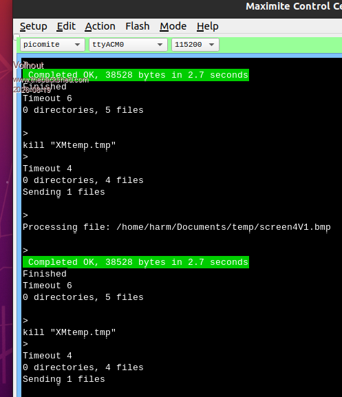

Small bug in MMCC: when transferring a file from PC to pico, using "temporary file".
When that file already exists (overwriting): everything is okay.
When that file did not previously exist(a new file): the renaming fails, and a file called XMtemp.tmp is left on the pico.

  Quote  Small bug in MMCC: when transferring a file from PC to pico, using "temporary file".
What sort of picomite?
I have tested with a picomite geek V6.3.0 and it transfers a new file correctly on both drive a and b

Hi Jim,
PicoMiteVGA V6.03.00
On the MMCC there is no error message, but on the VGA screen it is something like
XMODEM RECEIVE "filename.ext"
KILL "filename.ext"
Error: could not find the file
Visible for 0.1 seconds, then immediately the VGA screen shows the result of a FILES command (the directory listing).
There is no RENAME and NAME on the VGA screen.
In the directory listing is XMtemp.tmp.
The behaviour is independent on file size (tested 4k...500k) or file name (also tried 4 character extensions like ".flac").
On MMCC screen there is a timout message that I cannot relate.
Edited 2026-08-19 18:49 by Volhout

You can ignore the Timeout error message. It is a loop counter when waiting for a response. When the number approaches 100, I know there is a problem.
I have added a few delays and now only use the temporary file when the target exists.
That won't find the reason for the error but it should get around it.

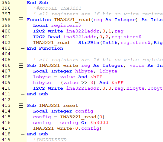

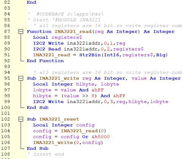

I have been playing a bit.
If the source/library files used tags to indicate the start and end of blocks of interest, code that is not within a SUB can be extracted.
Multiple SUBs can be grouped together and extracted in one go.
 '#MODULE INA3221
 ' all registers are 16 bit so write register number then read 2 bytes
function INA3221_read(reg as integer) as integer
 local registers$
 i2c2 write ina3221addr,0,1,reg
 i2c2 read ina3221addr,0,2,registers$
 INA3221_read = str2bin(int16,registers$,BIG)
end function
 ' all registers are 16 bit so write register number then 2 data bytes
sub INA3221_write reg as integer, value as integer
 local integer hibyte, lobyte
 lobyte = value and &hFF
 hibyte = (value >> 8) and &hFF
 i2c2 write ina3221addr,0,3,reg,hibyte,lobyte
end sub
sub INA3221_reset
 local integer config
 config = INA3221_read(0)
 config = config or &h8000
 INA3221_write(0,config)
end sub
 '#ENDMODULE INA3221
In the main code
#CODEMODULE filename$ modulename$
I also suggest that all the source files be stored under a common root folder to keep file names short. Subdirectories are OK
I can save the codebase folder name between sessions (in MMReplace.inf withot upsetting anything else) so if that doesn't change it won't need to be specified very often.
I have started butchering MMReplace to see how it works in practice.
I will try and use your existing functions where possible so my hack can be rolled in if desired.
