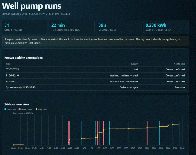

I've been thinking about having ChatGPT talk to the Dockstar via serial (which gives it root access). I got browser Chat to walk me through getting PowerShell codex (Chat API) to connect to the Dockstar and interact with it. I first had it characterize the well pump behavior. It looked through my log files and analyzed runs by day and period. Very good job, no interaction on my part.
I then asked it to graph usage on the day with the most cycles. This is what it came up with:
Beautiful. I told it that the 8am runs were a bath, the 2 periods near noon were washing machine fill and then rinse, and the 10pm one, the dishwasher. On several other days I pointed out periods of watering the garden.
