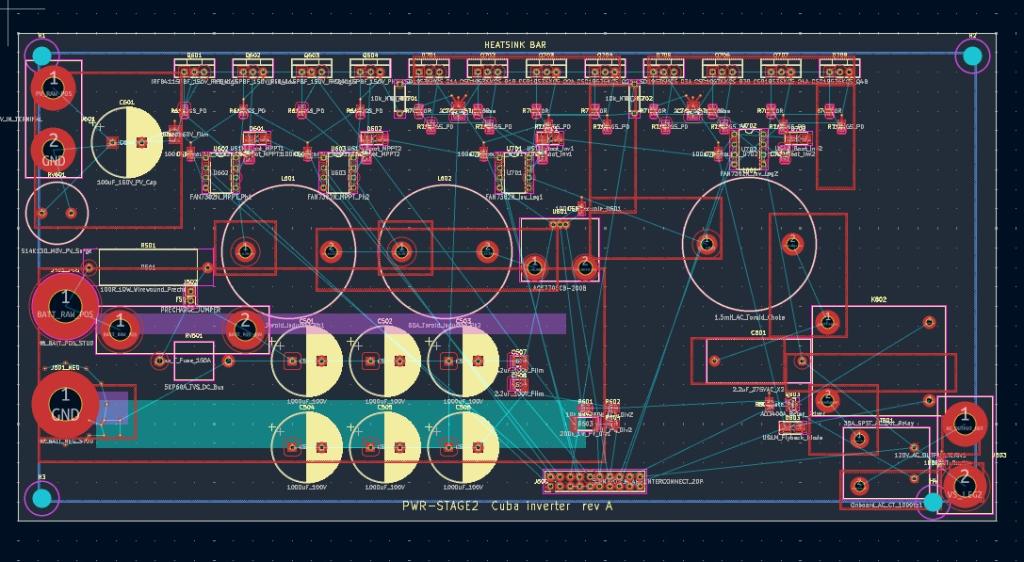

I asked Gemini if it could make the design. It cheerfully answered, "Yes". So it came up with a verbal spec. I asked it to make a Kicad netlist (I've used EasyCAD and EasyEDA, but not Kicad). It produced the .net file. I imported it into Kicad, got a bunch of errors, passed those back to Gemini, got a new .net file and repeated. It was going to be a slow process with me in the middle.
About then I got a message from Anthropic giving me a $100 credit to use with Fable 5. My first thought was that I wouldn't know how to use it since Opus 4.8 has been entirely satisfactory for talking directly to the hardware (Pico Computer 3 or any PicoMite 2 W or Dockstar running OpenWrt) and producing the programs I ask it to--vibe coding to the max. My second thought was, maybe Fable can do this PCB design. So I set it to the task, with me still in the middle. After a few turn, it said something which made me ask it if it was able to run Kicad internally. It said probably, if I downloaded to the the Linux AppImage version which matched my own. I found kicad-10.0.5-x86_64.AppImage.tar, downloaded it, and Claude confirmed that it could iteratively work through import and then DRC errors until it could give me an error free .net file. I asked it to go further and produce a .kicad_pcb file from which I could produce gerbers to send to JLCPCB. Gemini suggested a placement layout, and Claude gave me the unrouted .kicad_pcb file which I double-clicked on and it brought up the PCB with ratlines. I could see that one component with long ratlines would be better placed elsewhere, so I suggested that placement to Claude and it came back with a much better-looking layout.
I then asked it to do the routing. It talked to itself for a long time. Finally it had a file for me to double-click on. Everything looked routed, but the diagonal traces were stairsteps. I went back to Claude, and it fixed it
Pretty nice looking, I thought, but what do I know? So I fed the design to ChatGPT and it came back immediately and said, "Won't work. It's a buck design and you can't buck 48V DC to 120V AC--you need to boost it first." So I asked Chat if it could run Kicad internally with the AppImage. I gave it the tar file, and it said it tested out. I asked it to look at Solar Mike's Multi Phase PV Charger. Mike didn't include design files, but has many images of schematics and PCBs. I saved the browser page, which include a folder of images, and uploaded it to Gemini (which is perhaps the best AI with images). It figured out a .net file and recommended some parts changes--200V IXTP120N20X4 mosfet, FAN7382 gate drivers, unidirectional ACS770ECB-200B current sensor, MUR120 diodes. Gemini said it can't run the Kicad AppImage, so I asked it to produce a handoff document for Claude.
So Claude started work on it and finally produced a .kicad_pcb file, which it said was strictly a prototype for bench testing, and needed to have copper bus bars bolted on as Mike's design did. I produced gerbers and sent them to JLCPCB--$15USD for 5 boards. But again, what do I know? I'll have to use entirely new-to-me protocols in testing this relatively hig-voltage design (I've not previously worked with more than 24V). And the inductor is off-board.

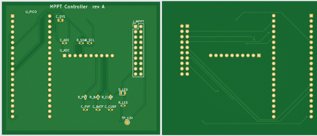

Claude did eventually route a controller board based on the Pico 2 W with an ADS1115 ADC module. It's not a very complicated board, and it worked on it for hours, routing and rerouting, with occasional prompts from me to wake it up.

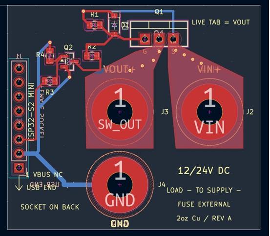

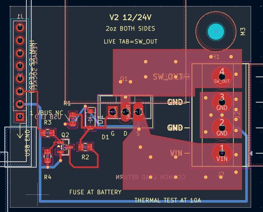

Codex confirmed the netlist and availability of the Kicad tools, and started in. It ran out of tokens and I had to wait several hours to restart. It ran out of tokens again in the middle of the night. When I started again the next morning, it finished in about 15 minutes. This is what it produced:
I said, Ok, but if there are copper lugs on GND and VIN, there will be no room to put one on SW_OUT. So it started again and produce the 3 positions for large lugs along the bottom. I said, Ok, but I don't really need to be able to switch 24V and 30A (as I had originally specified) for this particular use, so please do again with 5.08mm screw terminals on the right, in order from the top of SW_OUT, GND, GND, VIN. Once again it ran out of its 5-hour timeslot token budget, and I asked it to continue. This is what it produced:
I don't like its right-angle traces, but probably could have fixed that with another turn. I sent the gerbers to JLCPCB. I did not ask for 2oz copper (which would add $43), but plan to solder 14AWG wire between the mosfet pins and the screw terminal pins, and then between the GND pins. Since my last order a month or so ago, JLC has more than doubled both the base price and the shipping price, so I paid $10.38 for 5 boards. Still not bad, I think. If I actually needed lots of these boards they could be ganged 2x2 to cut the price to 50 cents per board.
I did almost nothing here except to describe to browser Chat what I wanted and then pass it along to codex. It's a long way from Peter's or Mick's skill level, but 3 months ago it couldn't do this. It may be fine now for modest hobby use. It uses lots of tokens, but I don't really care so long as I don't hit a hard monthly limit, which I probably don't since I don't do that many boards.

Perhaps a simple additional instruction that traces must not contain bends sharper than 45 degrees might be enough. It does seem to make some odd layout decisions though. :)
