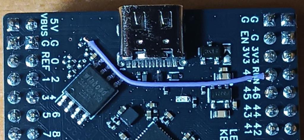

I have a WeAct board with an RP2350B. I soldered a PSRAM chip onto the board, which is addressed via GP47. Previously, MMBasic V6.03.00 was installed, and I was able to run programs on it. Now I want to flash V6.03.01, but I haven't succeeded because the board won't boot. I’ve already tried all the tips found online (press and hold BOOT, connect USB-C, press RESET, release RESET, release BOOT). However, the board does not appear as a drive on my PC. I can rule out the cable as the source of the problem, as I successfully used it to flash other identical boards. The board that won't flash still connects to the terminal without issues, so it isn't defective. I can also rule out the PC, since I was able to flash all the other WeAct RP2350B boards using it. The only difference is that one board has PSRAM connected to GP0, while the others have no PSRAM.
Does anyone have any advice on how I can still flash this board?

Either they have wired it wrong or you have soldered it wrong. The PSRAM chip shares the QMI bus with the main flash chip. If QMI is compromised then it won't boot

I have a board like that and have mounted PSRAM on it. It works fine with V6.03.00 and GP0 = PSRAM.
However, the CS operates via GP0, and I notice you’ve switched to GP47?
I don't have any experience with that yet, but I do plan to try it out using a separate wire connected to GP47.
The schematic shows the CS connected to GP0 via R14 (0Ω), so my plan was to locate and remove R14 and attach a separate wire instead.
The pull-up resistor R13 (10kΩ) is in the right place, and there is still room for a capacitor next to the PSRAM.
I imagine pin 1 (CS) of the PSRAM could be connected directly to GP47 using a short wire?

I simply bent Pin 1 of the PSRAM upwards and soldered a short wire to it. I connected the other end to GP47. I haven't soldered in the capacitor (yet).
Unfortunately, the resistor markings on the board are illegible even under a microscope, so I couldn't locate a jumper (0-ohm resistor).
However, I did measure a direct connection between GP0 and Pin 1 of the footprint. Since the pin on the PSRAM is bent up, though, it should work if you just connect Pin 1 to GP47.

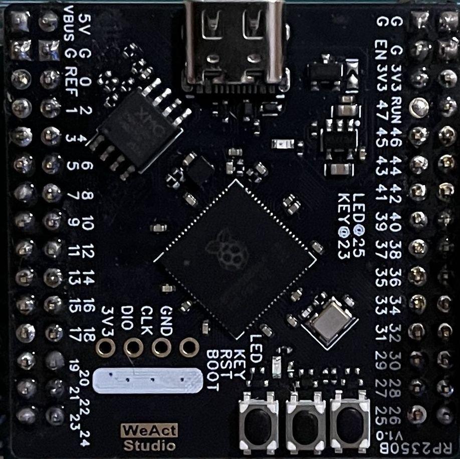

I hope we're talking about the same board. Mine is this one:

If you disconnect pin 1 from the board, the CS pin floats because the pull-up is no longer connected.
Leave pin 1 connected to the board, locate resistor R14 (0Ω), remove it, and install just the wire instead.

Peter, you're right. I removed the connection to GP47 and connected the PSRAM's CS to GP0. Now the RP2350B boots up again. Thanks for the tip.

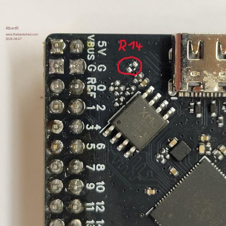

Posted: 08:18am 07 Aug 2026
v.lenzer
  Quote  Unfortunately, the resistor markings on the board are illegible even under a microscope, so I couldn't locate a jumper (0-ohm resistor).
I had identified it using the DMM
I wasn't sure if it would work because of the length of the wire.
But so far, everything seems to be working fine, even at 378 MHz.
Is there perhaps a program I can use to test it that puts a bit of a load on the memory?

I assume you removed R14, right?

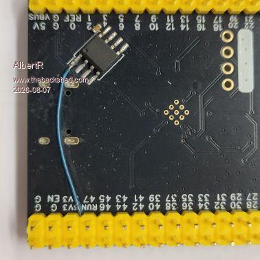

WeAct RP2350B PSRAM CS on GP47 MOD
WeAct_RP2350B_SCH.pdf

javavi,
Also a great solution for when the pins are already in place but there isn't much room for solder pads.
I used 0.32 mm enameled copper wire and secured it with superglue.
Now I just need to mount the assembly onto a perfboard and add a few other components for testing.
