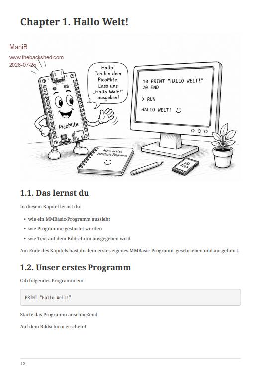

Hello everyone,
Over the last few months I have been working on a German beginner's tutorial for MMBasic, mainly for the PicoMite and the Colour Maximite 2.
The goal is to create a book that starts with the very first PRINT statement and gradually introduces programming concepts through practical examples and complete projects.
One of my main goals is that every major topic is accompanied by a complete, working BASIC program.
Rather than showing only isolated code fragments, readers can download and run the complete source code exactly as presented in the book. I hope this approach makes learning MMBasic easier, especially for beginners.
Some of the topics include:
- Variables and INPUT
- IF...THEN...ELSE
- Loops
- Arrays
- Strings
- SUBs and FUNCTIONs
- File handling
- Graphics
- Animation
- GPIO
- PWM
- Sound
- Interrupts
- Serial communication
- WS2812 LEDs
- Sprites
- Building complete games
The tutorial currently contains more than 500 pages and is still a work in progress.
To accompany the book, I have started a GitHub repository containing all example programs. At the moment, the first ten programs are available, and I will continue adding the remaining examples as I complete each chapter.
GitHub repository:
https://github.com/ManiBecker/MeinErstesMMBasicProgramm
Although the tutorial itself is written in German, all BASIC source code is language-independent and may be useful to other MMBasic users.
My current plan is to finish the German edition first. If there is enough interest, I may later create a completely new English edition rather than simply translating the existing book.
I would be very interested in your feedback.
Would a comprehensive English beginner's tutorial for MMBasic be useful to the community?
Best regards,
Manfred
PS: Here is a snapshot of the first chapter:

Good start in any way !!!!
TBH, I could never do something even close to what you've already done. Documentation was always my weakest point
I personally would have also set a focus on what the hardware is that you can run MMBasic on at the beginning. As PicoMite and Maximite are quite different targets, I feel it could be helpful for the reader to understand what is needed to get something running that covers his vision. This could be from a stamp sized board controlling some external hardware to a more or less self contained system. If you present that broad line of possibilities beforehand, maybe in some short examples ranging from-to (maybe just by mentioning some examples that one may imagine to be implemented), it could help the reader to get a better view of what he can excepect to get. From my POV you jump into the language without giving a broader picture first, but the language itself is only part of the game.

Hello Manfred!
I’ve just had a quick look at the website.
The barrier to entry is even lower than you describe.(point "Welche Hardware benötigst du?")
You can start with just a Pico and a terminal programme.
At least, that’s how it was for me. Then I soldered on the VGA output, then and an SD card reader and then the Audio output. It all cost just a few cents. If you’re put off by that, you can also try it out first with DOS-MMBASIC or MMB4W without needing any additional hardware at all.
But your book is still a brilliant idea; I’ll carry on reading it. Have a lovely weekend

Thank you very much for your kind words and your thoughtful feedback.
I think you have a very good point.
My original idea was to get beginners programming as quickly as possible, which is why I start with the first PRINT statement almost immediately.
However, I agree that readers who are completely new to MMBasic would probably benefit from a short introduction explaining the different MMBasic platforms and what can be built with them.
I already have photos of several MMBasic systems, so adding a short introductory chapter before the programming lessons sounds like a good idea.
Thank you for the suggestion!

  bfwolf said  Hello ManiB,
After a quick skim, I think your book is very well done — and the illustrations are a nice touch! It won't be of much use to me personally, as I would consider myself an "experienced programmer" , but I think my friends with less or no experience will like it and see it as very helpful.
However, I do have a few suggestions and ideas for improvement:
- There is no section or chapter covering data types (integers, floating-point numbers, strings). I would include this either under "Chapter 3: Variables" or, even better, as "Chapter 4: Data Types".
In "Chapter 3: Variables," you could add a note about the rules for variable names —specifically, that many characters are allowed, including special characters like `.` and `_` to improve readability.
- At the end of that section, you could also touch upon user-defined types using structures (`Type` ... `End Type`) and refer readers to a relevant chapter in "Part II – Developing Larger Programs" or, better yet, "Part VII – Advanced Techniques".
A great, easy-to-understand example is a data logger that stores A/D readings alongside a timestamp. This makes particular sense when a new value is saved only if it deviates from the last recorded value by a certain +/- delta; this allows you to capture long periods of data using very little RAM.
- I believe a previous version of the book included example programs with line numbers. It seems those have been removed?
You could still include a note explaining that older BASIC dialects relied on line numbers — where they were mandatory — whereas modern BASIC dialects do not require them. Consequently, line numbers are considered "obsolete" and "not recommended," though they are often still permitted (as is the case with MMBASIC). You could also mention that line numbers can serve as "jump targets" for `GOTO` and `GOSUB`, although named labels are the better choice. And that note, that one should avoid GOTO and GOSUB as much as possible, since modern BASIC dialects like MMBASIC offer other flow control tools (SUBs, FUNCTIONs, IF..ELSE..ENDIF, SELECT..CASE, etc.).
Otherwise: kudos, and keep up the good work!

Hi bfwolf,
thank you very much for taking the time to review the tutorial so thoroughly. I really appreciate your detailed feedback.
You raised several excellent points, especially regarding data types, variable naming rules, and the historical background of line numbers. I completely agree that these topics would make the tutorial more complete and easier to understand, particularly for readers coming from other BASIC dialects.
Coincidentally, your post comes at just the right time. I have recently started adding a public ROADMAP and TODO list to the GitHub repository so everyone can see what is planned for future versions and which suggestions have already been collected.
I've already added your ideas to the TODO list, including:
* a dedicated chapter about data types,
* additional information about variable naming rules,
* a later chapter covering TYPE ... END TYPE,
* and a historical note explaining line numbers and the evolution of BASIC programming style.
This way, everyone can follow the project's progress and see which ideas are planned for future releases.
Thanks again for your valuable suggestions and your encouragement!
