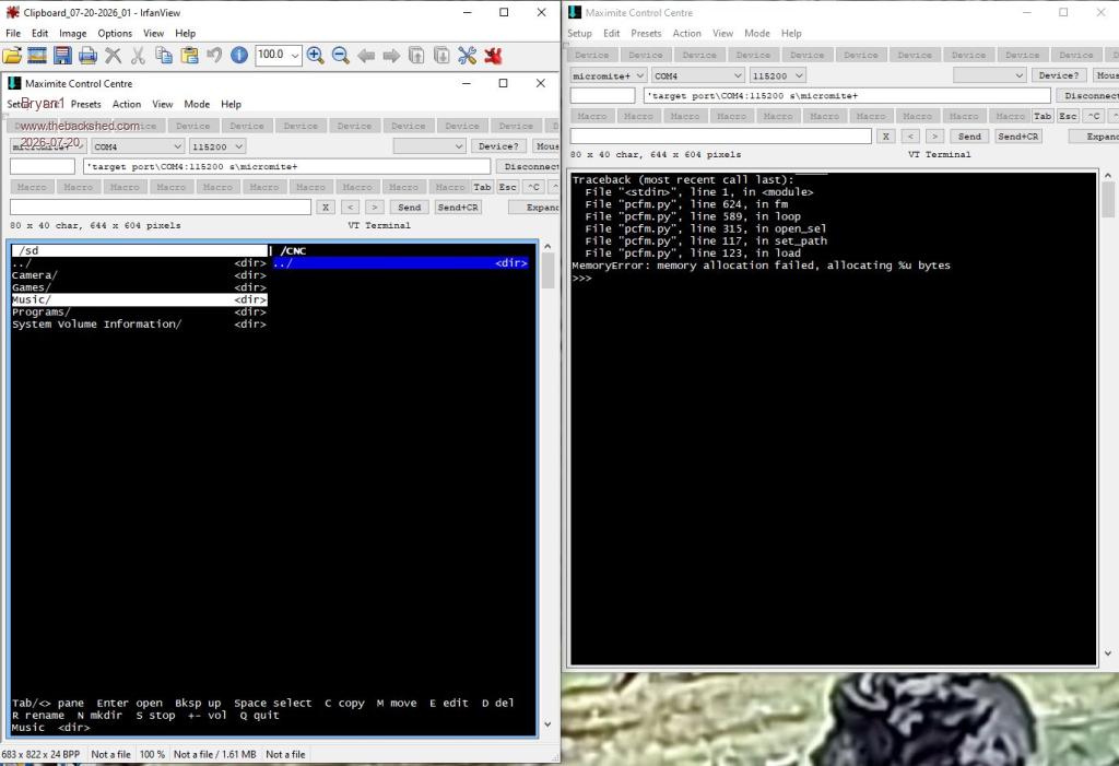

Ok second day going thru the book and went back to the start to refresh and decided as I hadn't tried playing any MP.3's I used fm() to navigate to /sd/Music only to find this....
Did a reboot and still the same, now my Bacoben MP.3 collection in in /SD/Music and the V3 PICO MMBasic it just worked. Now navigating to the other folders on /sd they just open with no problems.

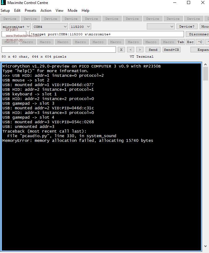

Ok when I did a reboot this morning got the message where a gamepad was on 3 when no game pad was inserted. So put a gamepad on and now got 2 assigned gamepads so took the gamepad off line and this error came up
So getting closer to finding out why the Music folder won't open and trying to edit "pcaudio.py" was empty may need more reading where I thought this would of worked off the bat.
Regards Bryan

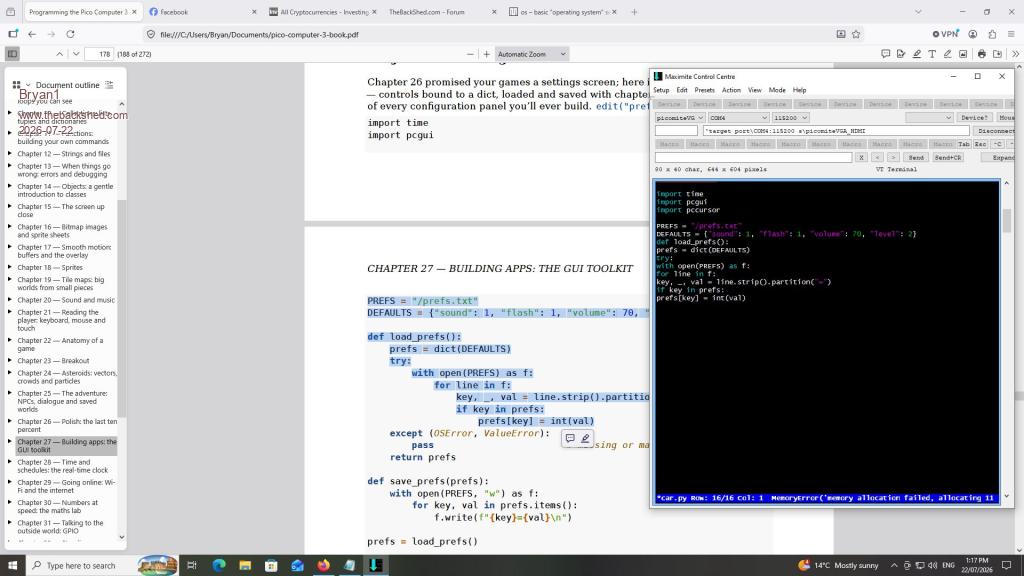

So this morning tried sending files to the board via MCCC and both xsend and mpremote also failed, now I did ask google AI for a simple database so I can learn and both as a txt and py file resulted in no bytes transferred.
So found copying from the book and pasting slowly into MCCC do show the code both on the terminal and the TV screen but trying to save keeps getting an error where the file won't save.
In the end I took the SDCard and did the walk.... to get the file across then saw the copy/paste did appear to work but no joy.

Well what I am finding I copied over the file in fm() from the SDCard and when I edit the file on the SDCard saving the file works yet trying to save the file in flash results in the MemoryError.
Now I did update to the 0.10 version now as I did do a clear 2350.uf after I loaded the new firmware all the files I made were still there.
Also teraterm is acting the same where mpremote and xsend refuse to work
Posts: 12054
Posted: 06:59am 22 Jul 2026
Have you got a PSRAM chip fitted AND working? Micropython for the PC3 won't run without one. Load MMbasic and check the PSRAM is seen
Bryan1
Joined: 22/02/2006
Posts: 2297
Posted: 07:14am 22 Jul 2026
Peter so is the psram U33 is the second IC down from 2350B chip? if so no JLCPCB didn't fit it along with the wifi chip.
I still need to find the part numbers for them so I can buy some and fit them.
Edited 2026-07-22 17:20 by Bryan1
Posts: 12054
Posted: 07:21am 22 Jul 2026
APS6404L-3SQR-SN - lots available on mouser etc.
I'm amazed Micropython even starts without that fitted
Edited 2026-07-22 17:22 by matherp
