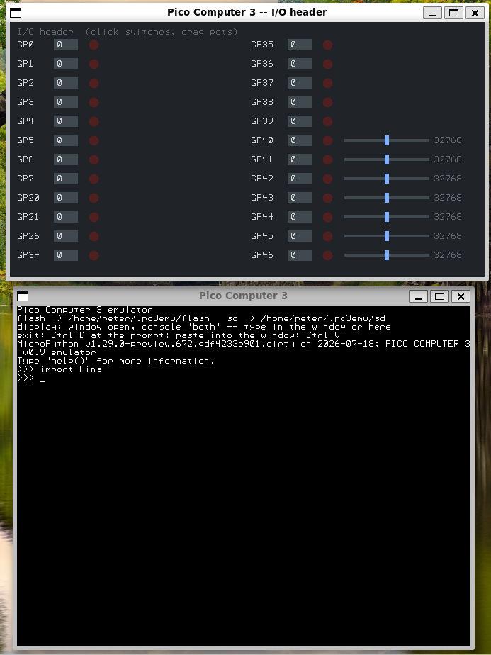

The emulator has exactly the same functionality as the real thing including video modes and audio other than the ability to physically control pins. However, if you "import Pins" in a program you will get a I/O panel so you can even test the basic I/O.

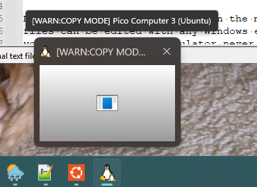

Posts: 6626
Posted: 06:51am 19 Jul 2026
If you are running Oracle Virtualbox, turning on Hyper V is likely to cause grief.
There are ways to run both systems but for now, I will look at installing the code on my virtualbox Linux instead.
That might solve my other issue:
I am unable to get anything other than the minimised view
The console functions OK but no display.
