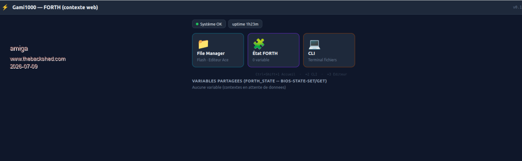

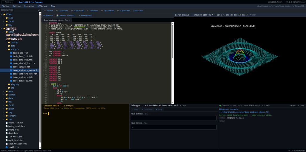

There's a full web-based IDE built in: code editor with FORTH syntax
highlighting, a DOS-style CLI, a step-by-step debugger with breakpoints,
and a simulated screen in the browser so you can test drawing code without
touching the real hardware at all.

**Demos**
The bouncing ball demo mentioned above is included and is honestly the
best three-second pitch for the whole project -- it's what convinced me
the interpreter swap was worth it. I'm also attaching/will follow up with
a couple of smaller demos: a live sensor dashboard (fake sensor data
flowing from a background context to the screen through the shared
state table, rendered as a gauge widget) and a plain drawing demo showing
the same script running unmodified on both the physical screen and the
browser's simulated screen side by side.

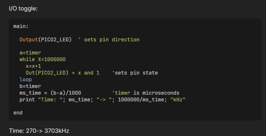

I have no idea where the speed comparisson comes from, but execution speed on MMBasic is 500.000 instruction per secon on CMM2, and over 100,000 per second on PICO. I have programs that run interrupt routines on 1ms basis, all in basic. No C, no assembly.

As Volhout said the PicoMite is reasonably fast.
Pico RP2040 @ 378MHz reading a pin.
> clear : dim integer n, x(9999) : setpin 1, din
> t=timer:for n=0 to 9999:x(n)=pin(1):next:? (timer-t)/10;"uS/loop"
13.2169uS/loop
Pico 2 VGA @ 378MHz
> clear : dim integer n, x(9999) : setpin 1, din :t=timer:for n=0 to 9999:x(n)=pin(1):next:? (timer-t)/10;"uS/loop"
8.6994uS/loop

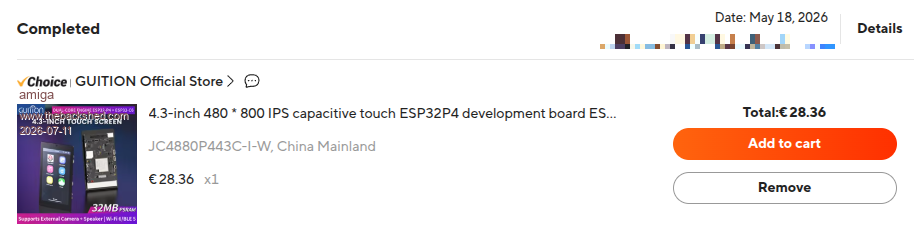

And the new chip from espressif 'ESP32-P4' is really a beast
With 2D engine,mipi,16MB spram,32MB flash but no wifi (i use a coprocessor ESP32-C6 (wifi,bluetooth and zigbee !).
On aliexpress i found a board with LCD mipi(800*400) +P4+C+ for 28€ .
It would be really interesting if someone or a group—looked into porting 'MMBASIC' to this processor. I’m talking about source-level compatibility, though obviously adapted to the hardware, since the processor handles all graphics, sound, and floating-point calculations—not to mention the 16MB of SRAM and 32MB of flash integrated into the ESP32-P4. Plus, the cost of the boards is negligible compared to their capabilities.

Benchmark with demo 'Bouncing ball' done with 'My-BASIC' vs 'FORTH' using the same stack .
FORTH was x76 times faster ! Not a counting loop . Real application .

There is always a BASIC solution
Coridium ArmBasic (compiler) on the RP2350 @150MHz
If I need TRUE multitasking that is jitter/latency-free (no interrupts), I use the eight-processor Propeller from Parallax and the FlexBasic compiler.
Edited 2026-07-09 17:44 by PhenixRising

  PeteCotton said
I particularly like the Boing Ball demo - nice touch.
Hihi, Those were my first steps in 6809 assembly back in 1986

  Martin H. said
Hi Martin,
It wasn't easy to finalize—there were plenty of issues managing LVGL buffers ,but the flexibility of Forth helped get the bugs fixed fairly quickly.
In the pipeline, there's a 'Workbench' like the one on the Amiga 1000... and I'm thinking of implementing the floppy drive 'click-click' sound.
It’s not an emulator or a recompilation of Amiga code; it’s simply capturing the spirit as a tribute to its brilliant creators and to Jay Miner’s little cocker spaniel, 'Mitchy' .
Personally, I have a little mouse of my own wandering around the house.

my current board ::
https://nl.aliexpress.com/item/1005010425057615.html
without screen ..
https://nl.aliexpress.com/item/1005009557354669.html

Very nice little boards. That one with the display is especially cool. :)

Annexe RDS , doesn't support the wifi part(the board use esp32-C6 as wifi co-processor)
But it support esp32-p4 and hope the screen also
