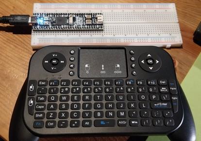

Now I have tested this keyboard, and it works OK

Posts: 12055
Posted: 09:19am 22 May 2026
Peter
Does the trackpad and game controls on that keyboard work?. You can use the device(mouse and device(gamepad functions to test them.
Edited 2026-05-22 19:19 by matherp

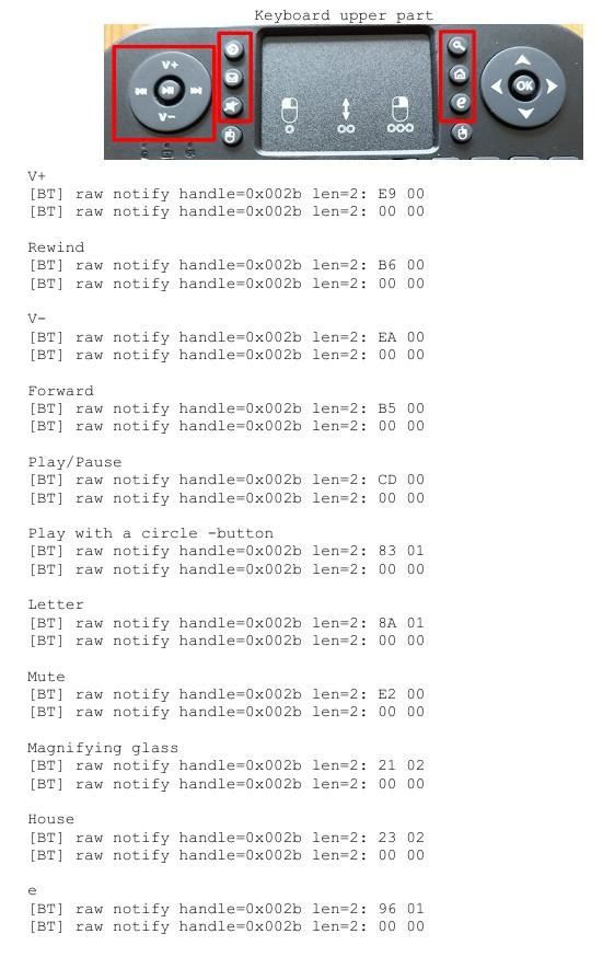

Posted: 02:48pm 22 May 2026

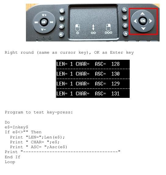

a few more tests I did on the mini keyboard
I can't get the trackpad to work, nor the mouse buttons.
/Peter63

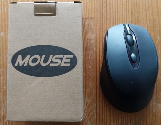

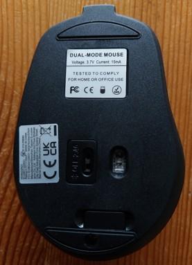

I thought I would try this mouse.
I don't really know how to test this, what device number does a BT mouse get?
/Peter63

Tested the mouse with this program:
xold=DEVICE(mouse 2,X)
yold=DEVICE(mouse 2,Y)
x=DEVICE(mouse 2,X)
y=DEVICE(mouse 2,Y)
b=DEVICE(mouse 2,L)
r=DEVICE(mouse 2,R)
m=DEVICE(mouse 2,M)
d=DEVICE(mouse 2,D)
If x<>xold Or y<>yold Then Print "X";x;:xold=x: Print " Y";y:yold=y
If b Then Print "Left mouse button":Pause 200
If r Then Print "Right mouse button":Pause 200
If m Then Print "Middle mouse button":Pause 200
If d Then Print "Double click of the left mouse button":Pause 200
End
, and it works.
The middle button was the one that did not work on this mouse.

Posts: 217
Posted: 09:31am 23 May 2026
I tested the mini keyboard again. Wanted to see if the trackpad worked, and sure enough it worked. Used the same program that I used when I tested the mouse.
/Peter63

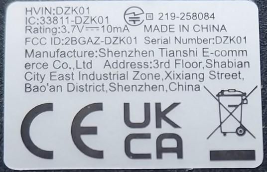

Posted: 02:58pm 03 Jun 2026

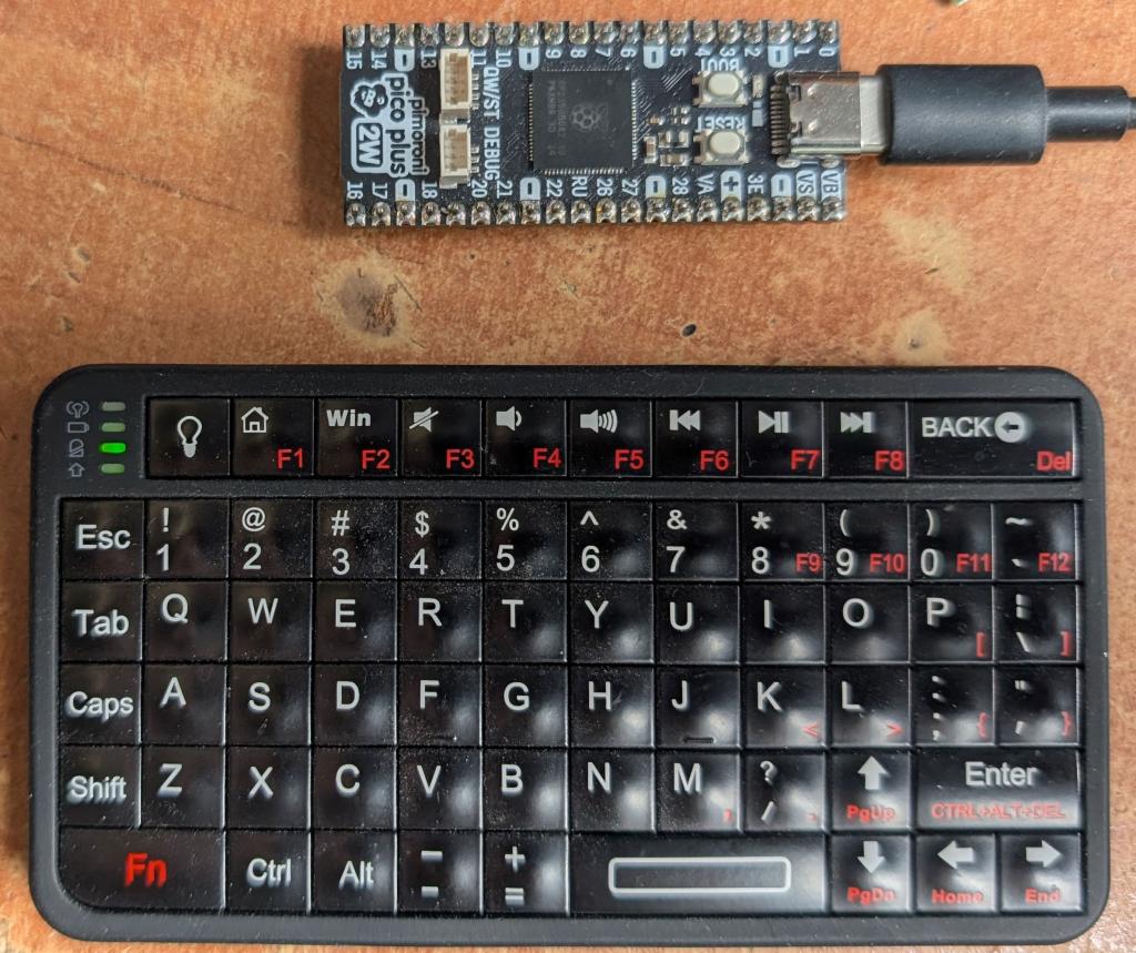

Just tested with this :
and it works nicely

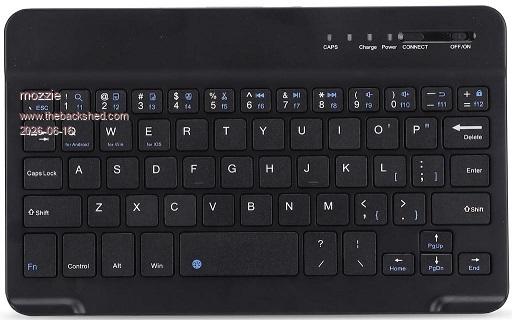

G'day,
Results of some testing for reference. Original RP Pico2W.
Keyboards listed as BlueTooth 4 or 5 seem to work fine, BlueTooth 3 (only one sample) does not.
Generic "Bewinner" 7-8" bluetooth keyboard, usually comes in "leather" folder for tablet.
Works well, big enough to type on, no backlight.
Generic "Micro" bluetooth keyboard. Do yourself a favour and spend a bit more on the Rii 518bt.
Works, too small for easy typing, has backlight.

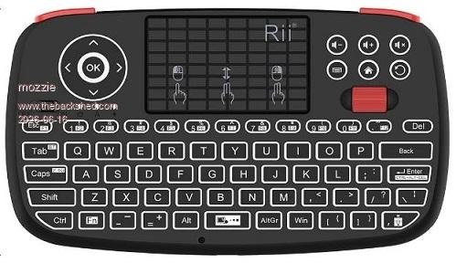

Rii I4 dual mode keyboard / trackpad.
Works well, too small for easy typing, trackpad works, has backlight.

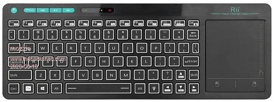

Rii RT518S dual mode keyboard / trackpad. Be careful, the K18 looks identical but is 2.4Ghz only.
Works well, big enough to type on, trackpad works, has backlight.

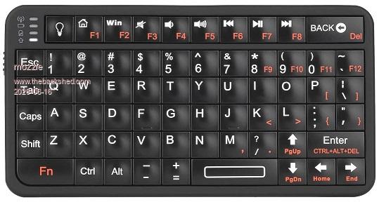

Rii 518BT keyboard.
Works well, key shape makes it fairly good to type on despite tiny size, has backlight.
The Rii keyboards are a bit more expensive than the generic stuff but seem to be pretty consistant. I have a few others and they survive abuse in the workshop quite well.
Only things that fail to work are the scroll wheel / scroll function and the CAPS LOCK LED.
Thanks again to Peter for implementing this, could prove to be very handy.
Regards, Lyle.

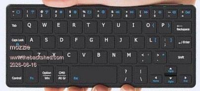

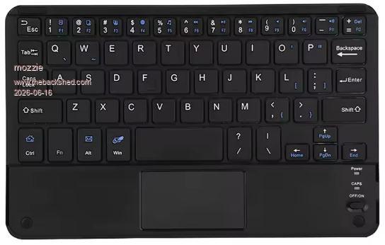

And those that didn't work:
Generic "Magnetic Bluetooth keyboard / touchpad", this shows as "BlueTooth 3"
And be wary of these, no function keys could make life difficult.
Regards, Lyle.

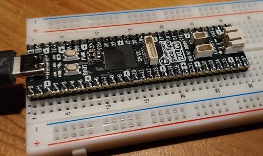

Tested version: PicoMiteBTH MMBasic RP2350B V6.03.00RC24
Just letting you know that my little mini keyboard (BT) works on version RC24
Using-board: Pimoroni Pico LiPo 2 XLW (PIM776)
> option list
OPTION FLASH SIZE 16777216
OPTION COLOURCODE ON
OPTION KEYBOARD US
OPTION HEARTBEAT OFF
OPTION PICO OFF
OPTION CPUSPEED (KHz) 200000
> Bluetooth Keyboard Connected
 /Peter63
