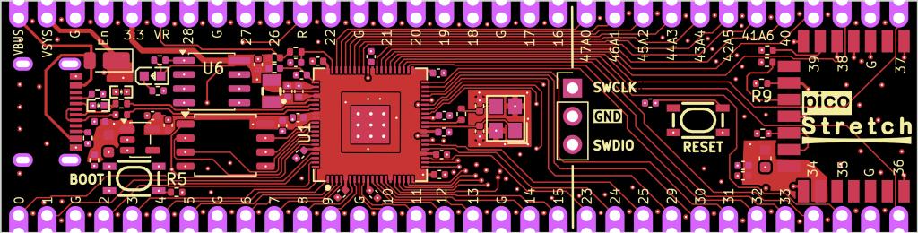

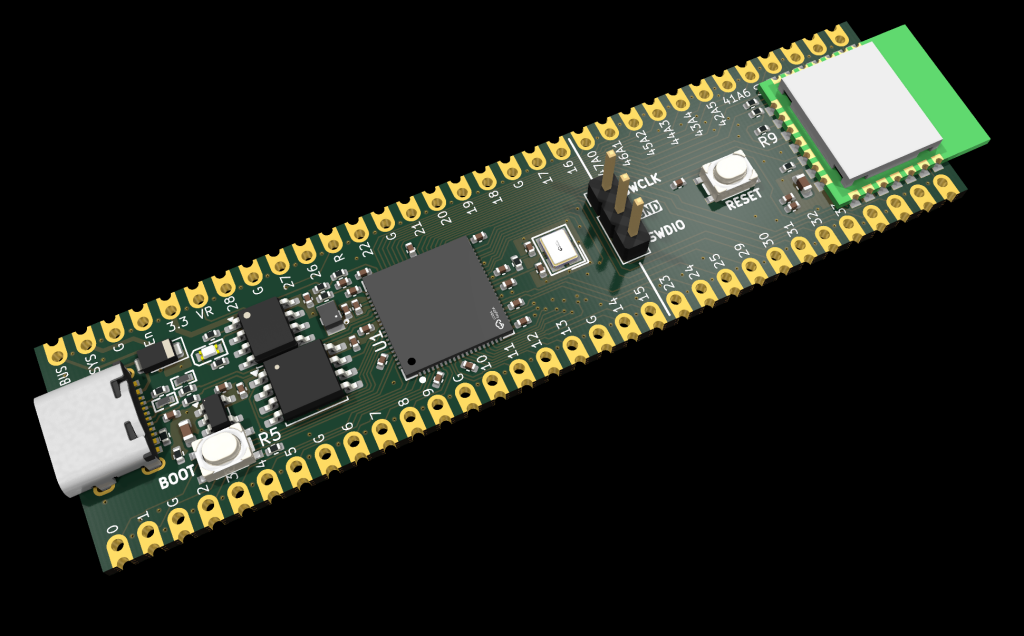

This is no-compromises RP2350B dev board that breaks out all 48 GPIOs. It's inspired by the Pimoroni Pico LiPo 2 XL W, which still supports the original 40 pin layout of the 'classic' Pi Pico boards. I think the pimoroni board does way too much, and I am not sure why it has castellated edges, because it's got chips on both sides, it can't be soldered down.
My goals for this version:
- 16MB Flash / 8MB PSRAM (CS GP0)
- Expose all 48 GPIOs with castellated edges (a common nit with previous versions)
- Support the original Pi Pico footprint for the first 20 pins on either side
- USB-C / Radio Module 2
- Everything on the top side so it's solderable (there are solder jumpers on the back side)
- Try to keep trace routing sane with not too many vias.
I haven't sent this version to production yet, and am looking for feedback. I have made PCBs based based on the same schematic but with a different PCB layout, and it all works. I have one in my PicoCalc right now.
You can find the kicad files here: https://github.com/jvanderberg/pico-stretch2. It's a 4 layer board with Inner1/Inner2 as ground planes. This helps with signal integrity and EMI for the traces that do have to move from the front to the backside.
Definitely would appreciate feedback before I send this off to production.

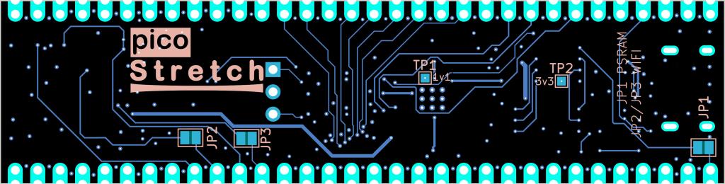

Please make the PSRAM CS signal configurable via solder jumpers, at least between GP0 and GP47.
And route the USB signals to the contact pads on the underside of the board near the connector.

  javavi said  Please make the PSRAM CS signal configurable via solder jumpers, at least between GP0 and GP47.
I'll think about the first, it might be pretty hard given the layout, but there's still a lot of freedom once you get to the backside.
The USB pads are a good idea, I think that should be easy.

I wasn’t able to view the schematic; if possible, please export it in an accessible format.
Preferably, the radio module should not use any of the ports of the original Pico module.
Pay attention to the quality of the components in the chip’s power circuitry.
With proper core power, the RP2350 chip is capable of operating at 504 MHz.

  javavi said  I wasn’t able to view the schematic; if possible, please export it in an accessible format.
I posted the link to the full KiCad repo, that’s got everything. Images of schematics on the web just tend not to turn out well.
My existing boards based on this same schematic are pretty overclockable. I think you just have to get the 1v1 inductor right, and they basically hand hold you through the proper layout and give you the exact part they bless.
I agree with you! AFAIK GP0 is default for SPI0_RX or UART0_TX in PicoMite (don't remeber exactly). Pimoroni-Pico+2 also uses GP47 for PSRAM_CS.
Agree with PSRAM CS and I think the best for own designs with your board is to expose USB and bootsel to the pinheader.

GP0 isn't used by default for anything using MMBasic. The Pico pinout shows it as default for COM1 TX (UART0) but the one to avoid is GP8 as that is COM2 TX, default for the MMBasic serial console or PS2 keyboard.
GP19 conflicts with VGA.
GP47 is best avoided as that's ADC7, even though Pimoroni use it for PSRAM select. It's easy enough to rewire their PGA2350 to use GP0 rather than GP47 providing you do it before installing the pins.
For MMBasic GP0 is definitely the best choice for PSRAM.
If I have a niggle it's the format in general. I can see a huge advantage in that it's breadboard compatible, but like Peter's design it's not a format I fancy attempting to fit onto a PCB unless it's a big one. As a development board, yes, maybe, but it's a fragile thing at that length with very fine traces. Only my own preferences, of course. :)

GP0 is the default for SSD1963 so I like GP47 better.
I agree that it is going to be mechanically fragile, Pimoroni had quite the same with the  Pico Plus 2W XL but as I looked today it seems they took it out of their shop..
My idea would be to separate the RM2 and design a breakout board for it. With this every Pico could be turned into a Webmite..

  Mixtel90 said  GP0 isn't used by default for anything using MMBasic. The Pico pinout shows it as default for COM1 TX (UART0) but the one to avoid is GP8 as that is COM2 TX, default for the MMBasic serial console or PS2 keyboard.
Thank you for the feedback.
Yeah, GP0 has worked well for me so far with MMBasic on previous versions of this board. If it's not hard I will probably add selectable solder jumpers for 0 or 47.
One of the reasons I spent 12 hours re-laying out this PCB was because previous versions used extremely thin traces, very closely spaced. This version isn't perfect, but it's better. Cross-talk will be a thing, but it's minimized by the interior ground planes. 4 layer boards appear to be rare in the space, but with JLCPCB, it's not really much of a cost concern.
It's not physically fragile, and electrically it seems robust enough. It overclocks well. I've got a previous version with an HDMI hat running fully loaded MMBasic - I2S sound, SD, Wifi, HDMI out, USB keyboard.
The big benefit (I think) is being able to put this into existing designs that take a Pico. Raspberry Pi made a defacto 40 pin standard with their original board, and so many hobbiest projects use it, but it's really limiting on the GPIO front. So this is an attempt to square that circle.  If there's physical room, this board can still drop into those projects, but if you want to use it for prototyping with all the GPIOs, you can do that too. And dare to dream, maybe I could start a new defacto 64 pin standard.

I did a design some time ago (I don't think it was published, I never got one made anyway) using a SSD1963 with a PGA2350. That was remarkably compact when laying out the traces. I used GP0 for PSRAM as you can now specify DB0pin for the SSD1963 - I started the 16 data lines at GP2 so that the high speed counter on GP1 could be brought out.
AFAIK it's only Pimoroni that have standardised on GP47 for PSRAM. Everyone else would rather have 8 ADC inputs and have to use an alternative pin for UART0 TX.  :)
Posts: 12055
Posted: 11:44am 19 May 2026
SSD1963 is much faster when using gp0-7/15 so it is recommended to use GP47 for PSRAM
