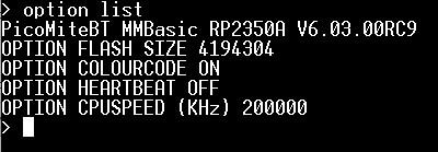

Posted: 05:01pm 18 May 2026
PicoMiteBTRP2350V6.03RC9.zip
NO USB console, NO serial console, JUST A BLUETOOTH CONSOLE
Requirement Pico2-W or Pico Plus 2W. The firmware is basically standard PicoMiteRP2350 with the substitution of bluetooth for the CDC connection.
Manual
PicoMiteBT.pdf
Known issues:
Autosave of large files flakey
xmodem not working

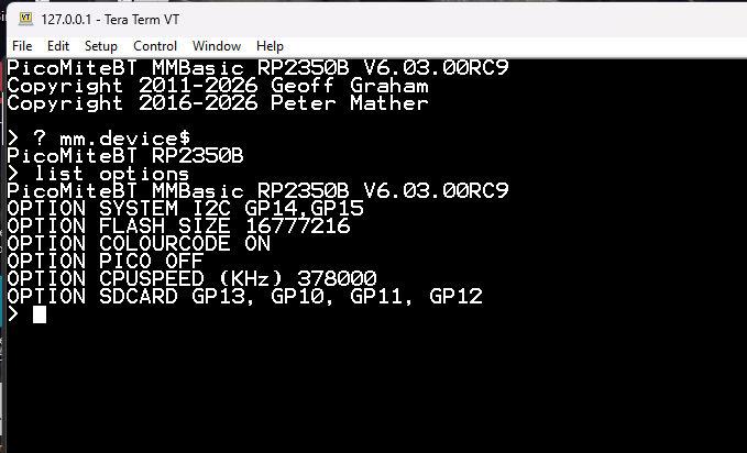

Posted: 03:59am 19 May 2026
Hello
Have tested the PicoMiteBT version, and it works ...
I have tried using a Windows 11 computer, and TeraTerm.
"I am as happy as a penguin in a microwave", quote from QI TV series
/Peter63

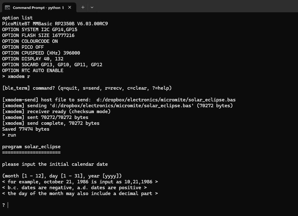

Posts: 12055
Posted: 08:30am 19 May 2026
Xmodem and Autosave now working. Build is tested up to 396MHz on a Pico Plus 2W.
If using on Linux note the change to the manual. The fix was part firmware and part the bridge so both are needed.
The code is a standard PicoMite RP2350 build with the USB CDC interface swapped for a BLE NUS interface. It does not have any other bluetooth or web functionality
PicoMiteBTRP2350V6.03RC10.zip
PicoMiteBT.pdf

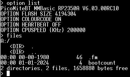

Peter63
Joined: 28/07/2017
Location: Sweden
Posts: 217
Posted: 08:57am 19 May 2026
Yep, PicoMiteBT RC10 works too. I will try a little more...
/Peter63

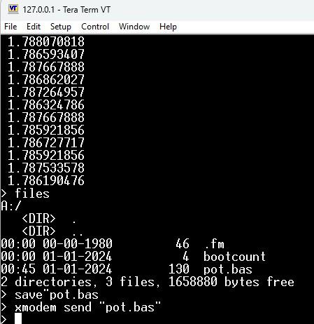

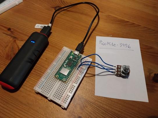

Test of PicoMiteBT, RC10.
A small test program that shows the value from a potentiometer (10K).
' Read a pot. , using PicoMiteBT RC10
SetPin gp26, ain
'SetPin gp26, araw
Print Pin(gp26)
Pause (100)
End
Setup:
Test XMODEM SEND ...
/Peter63

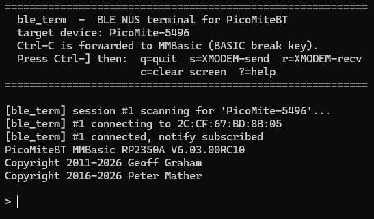

Posts: 12055
Posted: 01:54pm 19 May 2026

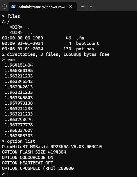

I've created a standalone MMbasic specific terminal for BLE NUS. You can use this instead of the bridge. Should work on Windows or Linux as long as Bleak is installed (pip install bleak). Just open a command window and execute the python command. e.g.
python ble_term.py PicoMite-77BA
Assuming you have the PicoMiteBT paired as explained in the manual then you then are in a vt100-like terminal. No teraterm or putty required.
ctrl-] is a magic key for exiting and invoking xmodem
ble_term.zip
PicoMiteBT.pdf
Edited 2026-05-19 23:57 by matherp

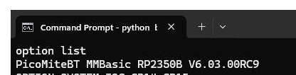

Peter63
Joined: 28/07/2017
Location: Sweden
Posts: 217
Posted: 03:43pm 19 May 2026
  Quote  I've created a standalone MMbasic specific terminal for BLE NUS. You can use this instead of the bridge. Should work on Windows or Linux as long as Bleak is installed (pip install bleak). Just open a command window and execute the python command. e.g.
Tested on RP500+
/Peter63
