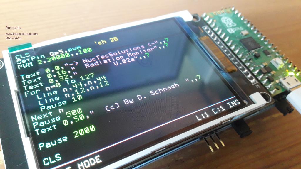

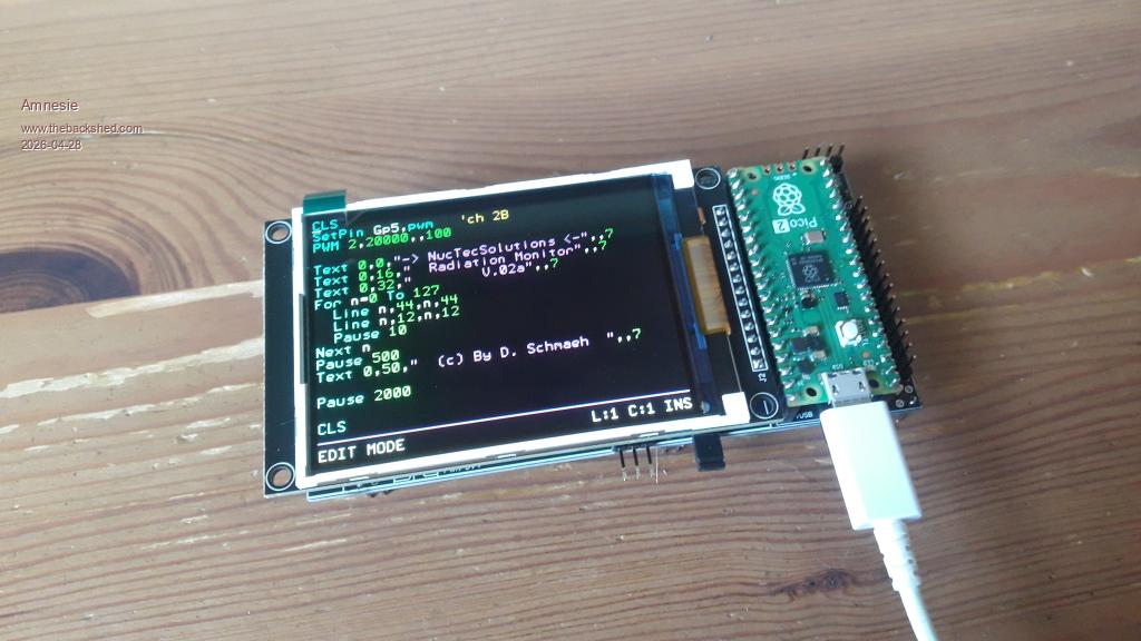

Hello,
I only want to report that the ILI9341V does work with the picoMite.
I know there were some questions if this "V" type display with IPS will work - now I can say: it does. You only have to use the "invert" option when using:
OPTION LCDPANEL ILI9341, L, GP15, GP14, GP13, ,INVERT
The display is amazing, I'm never going back to the normal TFT! IPS is far superior.
When it comes to touch, I can't test, because my version does not have touch. But would be interesting, since it is capacitive.
Some pictures:

Hi Daniel, what carrier board are you using? (ie What's underneath?)

  BarryH said  Hi Daniel, what carrier board are you using? (ie What's underneath?)
Hello,
this is my own design.
Greetings
