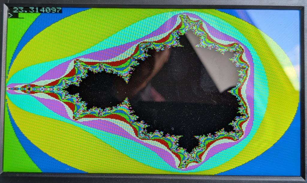

On a HDMIUSB system with OPTION RESOLUTION 640,378000 set this takes 42.4 seconds
However, add the magic line at the top
Option tracecache on
and.....

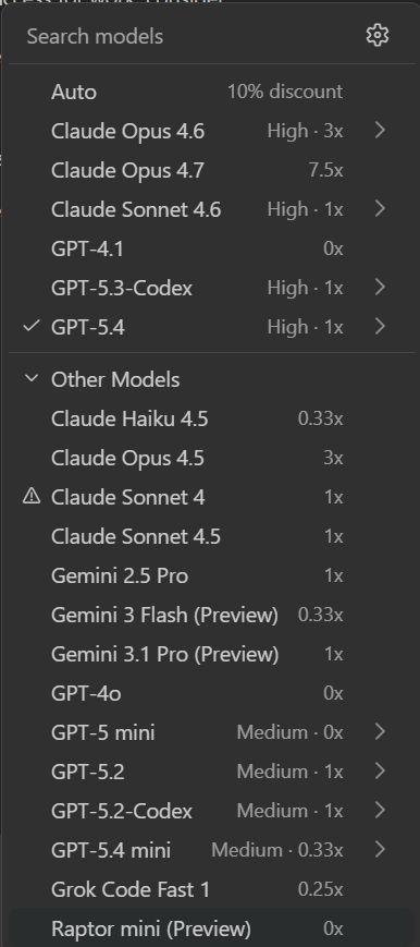

Note: the header text in the c file is completely out-of-date with respect to the current capabilities. This was built in increments using Claude 4.7 - very expensive to use but largely infallible in terms of each step meeting the brief and working first try.

  matherp said  built in increments using Claude 4.7 - very expensive to use but largely infallible in terms of each step meeting the brief and working first try.
How expensive is "very expensive"? I spent about $5USD a day for 5 days to work out some deep bugs--fairly intensive use, but far from "all day, every day". Expensive for a retired person doing it for recreation, but not for paid development.
Since that stretch I've managed lighter use on the monthly subscription--several times hitting a period limit and then doing other things for several hours until the next period rolled around.
Edited 2026-04-20 00:35 by lizby
Posts: 12056
Posted: 04:06pm 19 Apr 2026
  Quote  How expensive is "very expensive"?
USD26 in a day
Posted: 04:17pm 19 Apr 2026
