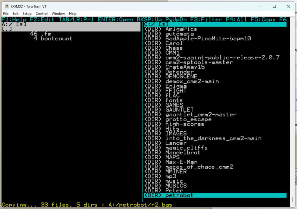

Posts: 11782
Posted: 05:30pm 14 Apr 2026
Attached is the HDMIUSB code if anyone wants to try it. Check the updated spec - lots more goodies now included. The key point about this is that is should be possible to work entirely within fm. There should be no reason ever to have to go the command prompt other than things like changing options.
PicoMite.zip
RP2350 PicoMite version (ashould work on PicoCalc)
PicoMite.zip

Posts: 9081
Posted: 06:28pm 14 Apr 2026
Wow.....!

Posted: 07:41pm 14 Apr 2026
Hi Peter,
Should up/down arrow auto repeat when single line scrolling up/down through list of files, I realise maybe not once you get to top/bottom of screen because of the slow refresh, but when scrolling through a list that is wholey on screen would be nice, I'm using a USB keyboard.
If I load a program with F2, then make some trivial change and run it with F2 the Pico locks up, needs a reset.
Otherwise looking very nice, works in all the resolutions I've tried, haven't tried most of the features yet.
Kevin.

  matherp said  Also coming soon - what am I missing?
@Peter: I'm not sure if you implemented the File Manager as an "internal command" or as an "internal BASIC library"?
But @Kevin gave me a crazy idea:
If "FM" is an internal command, couldn't it also be turned into a "standard file requester" that could be used from within programs? So, if the File Manager is also a function called "FM$()" (or whatever name it ends up having), we could pass it a "selector" as an argument to determine whether file manager or file requester functionality is required. If file requester functionality is desired, we could add an additional argument, namely a `ByRef filename$`, which would return the selected file. And the return value could be "OK" or "CANCEL" if it's a string, and, for example, 0 or -1 if FM() had an integer return value.
What do you think?
A Requester would essentially just be a "reduced file manager": only 1 panel and only 2 buttons.
Regards, bfwolf.
I’d love to see a HEX editor added to the File Manager. That would really round things off nicely. Would it make sense to implement XTERM send and receive in the File Manager as well? Just some ideas :-)

I have tried FM, a little. When I go into F2 edit, and leave edit, something strange happens. I will test further but that is what I have discovered so far.
using PicoMite RP2350A, I hope I am using the right file
(using file 2026-04-15_035310_PicoMite.zip)
/Peter63
Edited 2026-04-15 11:00 by Peter63

Thanks Peter,
It may be there, or may not be necessary, but can there be an alternative option (within FM) to Launch from RAM?...just to be fanatical with minimising flash writes.
For example right now I use something like
RAM FILE LOAD 2,"C:/MM/Test1.BAS",O
RAM RUN 2
Or maybe more generally useful, to have user-defined function keys(could seed in the directory/file substitution parameters), the commands (re)configured for everyone's different workflow
F11="RAM FILE LOAD 2,%d%/%f%"
F12="RAM RUN 2"
Just ideas thrown out there!
Really loving the USB Comms & USB flash drives. Brilliant. Thanks again,
Phil
Edited 2026-04-15 13:34 by flip

Just to clear one thing up. Ignoring FM, if you edit a file rather than the in-memory program then exiting with F2 does the same as F1. FM is the same. Exiting an edit with F2 returns you to the filemanager. To run the file you then need to press enter
