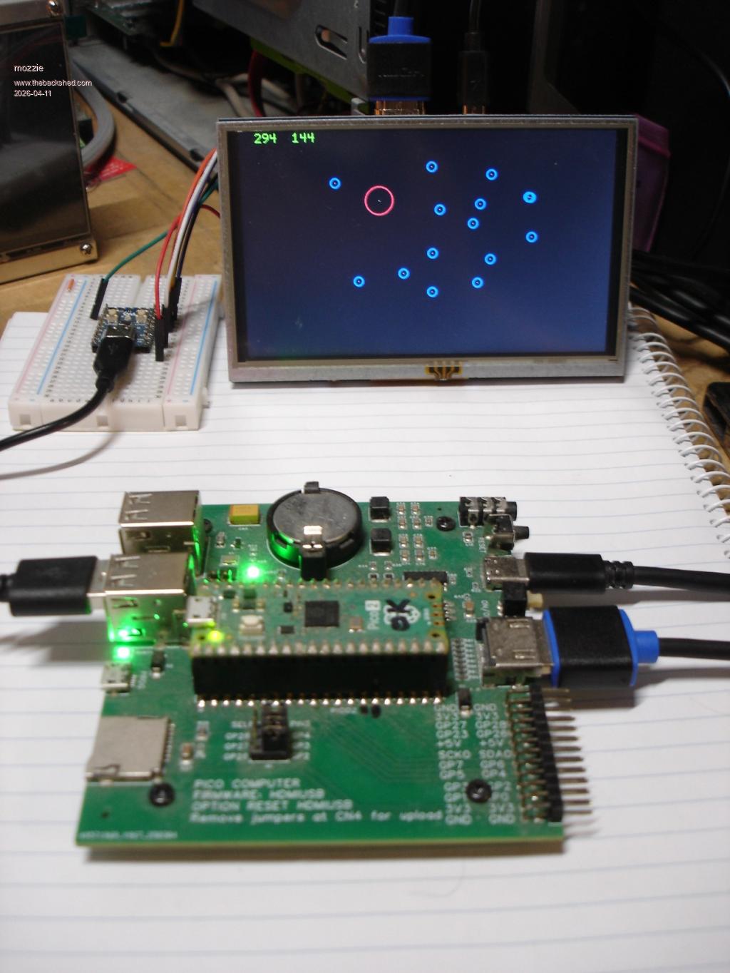

This has been on the wish list for a very long time, and whilst currently only proof of concept, hopefully some further work will make it useful.

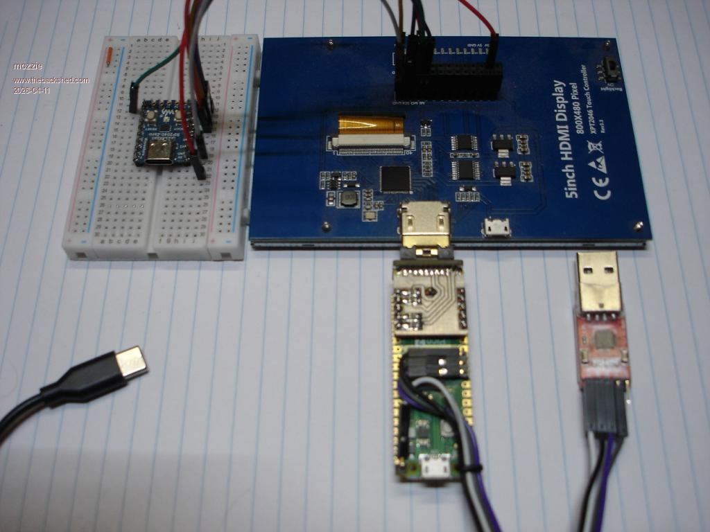

The idea is to have a 10" resistive touch monitor (5" version pictured) that can be plugged into a PicoMite-HDMI-USB with only a HDMI and USB lead connecting them, much like a normal monitor. These are available from Waveshare and others in various sizes and with the XPT2046 touch controller for use with a Raspberri-Pi.
This has been made possible with Peters addition of the USB-CDC capability in the latest firmware.
The RP2040-Zero is wired to the XPT2046 and configured with LCDPANEL VIRTUAL_M (640x480)
The RP2040-Zero is plugged into the USB-HUB on the PicoMite-HDMI-USB and uses the USB-CDC to send the touch coordinates etc
Only touch down currently supported, more work required to write some software to use it.

The next idea to try is running a PicoMite with a virtual LCD and the GUI elements enabled with touch, sending its video buffer via the new 4-bit memory transfer routine to a PicoMite-HDMI driving the screen.
Also need to figure out how to inject more power into the USB, the 10" screens drag a lot of juice. Off to order one now
