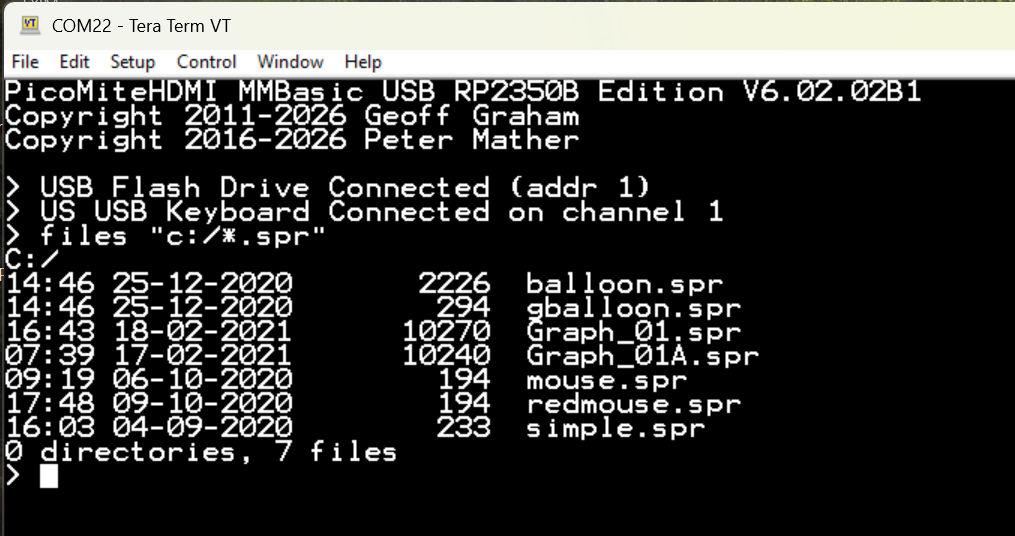

Full support for USB flash drives implemented as drive C:
HOWEVER
runs like a dead pig
It transpires that a combination of the rp2040/rp2350 USB hardware and TinyUSB limits reads and writes to one 64-byte packet every millisecond. i.e a maximum thoughput of 64Kbytes/second.
This means that although it could be used for loading and saving files etc. it is too slow for streaming any sort of audio and, as an example, a bmp file which takes 1.3 seconds to load from sdcard takes over 17 seconds to load from the USB disk.
What a waste of a day
