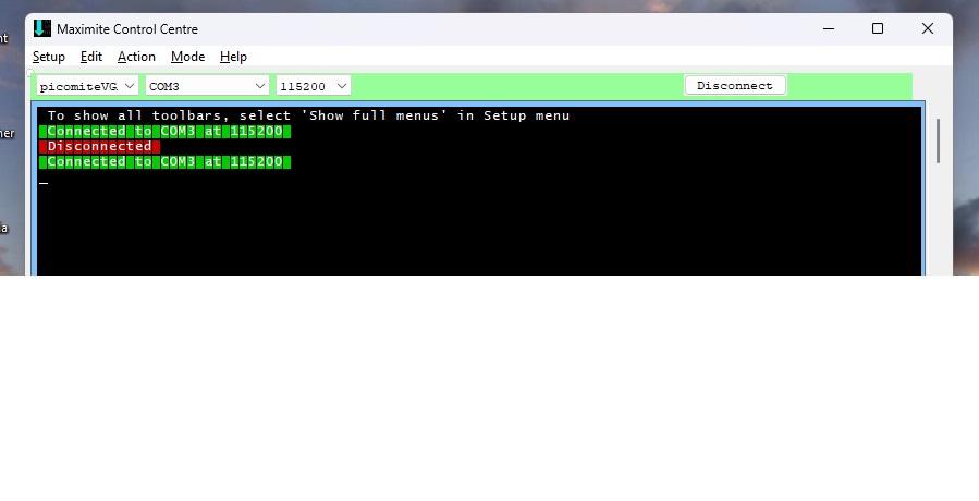

Posted: 11:20pm 25 Mar 2026
This version doesn't work with mmedit-mmcc. the terminal goes red highlight text and no keyboard, All working before
PicoMiteHDMI MMBasic USB RP2350A Edition V6.01.00b11
OPTION SERIAL CONSOLE COM2,GP20,GP21
OPTION FLASH SIZE 4194304
OPTION COLOURCODE ON
OPTION KEYBOARD UK, 0, 0, 600, 150
OPTION RESOLUTION 640x480 @ 315000KHz
OPTION DISPLAY 20, 40
OPTION SDCARD GP2, GP6, GP7, GP4
OPTION AUDIO GP0,GP1', ON PWM CHANNEL 0
OPTION DEFAULT FONT 3, 1
I don't know why and only know mmedit not xterm
regards, stan
Posts: 6579
Posted: 05:09am 26 Mar 2026
Sorry Stan, I can't help you with MMEdit.
I don't have a HDMI USB configuration set up but I thought that once the firmware is loaded you can forget about the PC terminal program and use your keyboard/monitor stand alone.
MMCC only talks to your USB-serial chip which I assume hasn't changed.
Every other version I have loaded performs as expected.
Edited 2026-03-26 15:14 by TassyJim
Posts: 6049
Posted: 07:33am 26 Mar 2026
  stanleyella said  This version doesn't work with mmedit-mmcc. the terminal goes red highlight text and no keyboard, All working before
regards, stan
Stan,
Wrong thread. This is the V6.02.01 release thread. You are asking about a beta of V6.01.00.

Posted: 02:33pm 26 Mar 2026
regards, stan
Stan,
Geoff, Peter,
What I have tested so far, all seems to work on RP2040 VGA. Congratulations on this new milestone. I am especially happy with the speed gain for 2040 (also Game*Mite).
That is my old options list that I got to set up on latest version but mmcc says connected and I chose picomite vga-hdmi but mmcc no pc ketboard response.
The pico usb keyboard works, characters typed appear on hdmi monitor.
maybe I should have flash nuked before but mmcc terminal doesn't work.

Posted: 11:13pm 26 Mar 2026
to see if mmedit faulty connected an ili9341 usb board and worked ie programmable so no idea why latest don't work with mmedit/mmcc.
option list
PicoMite MMBasic USB RP2350A Edition V6.01.00b10
OPTION AUTORUN  ON
OPTION KEYBOARD UK
OPTION CPUSPEED (KHz) 378000
OPTION LCDPANEL CONSOLE
OPTION LCDPANEL ILI9341, LANDSCAPE,GP15,GP14,GP13
OPTION GUI CONTROLS 4
OPTION TOUCH GP12,GP11
GUI CALIBRATE 0, 3900, 3816, -886, -658
OPTION SDCARD GP22
this works but the new version doesn't work in mmedit like image, no keyboard,
Edited 2026-03-27 09:18 by stanleyella
Posts: 6049
Posted: 08:29am 27 Mar 2026
Stan,
Please confirm.
You have a pico-2 system that uses an ILI9341 LCD display, and connects to a USB keyboard. The console is a CH340 connected to GP8/GP9 and works in TeraTerm. But not in MMEdit/MMCC.
Please show a photo of your setup. It is hard to help with little information.
Maybe OPTION AUTORUN OFF ???
P.S. I have seen a similar incident before on my linux system, and re-installed MMEdit/MMCC 5.37 to solve it. The strange thing was that when MMEdit opened MMCC that MMCC would connect to the pico, but when I manually opened MMCC and pressed the CONNECT button, it would not connect. Regardless the settings I changed. After re-install all worked. Maybe a configuration file got corrupt.
Edited 2026-03-27 18:59 by Volhout
ville56
Joined: 08/06/2022
Location: Austria
Posts: 563
Posted: 09:02am 27 Mar 2026
MMedit/MMCC do work reliably if the setup is ok. I was outsmarting myself already several times with the Olimex USB/HDMI board. It is a bit tricky if the defaults in MMBasic and the board hardware or setup are not the same as soon as you lose the USB/serial connection. So connecting the serial console forth and back and uuups... where has my serial gone to now??? It was always my bad, connecting the the serial converter to the right pins always solved it. And yes, there is always the chance to reverse TX and RX too. I've done all that already
73 de OE1HGA, Gerald
