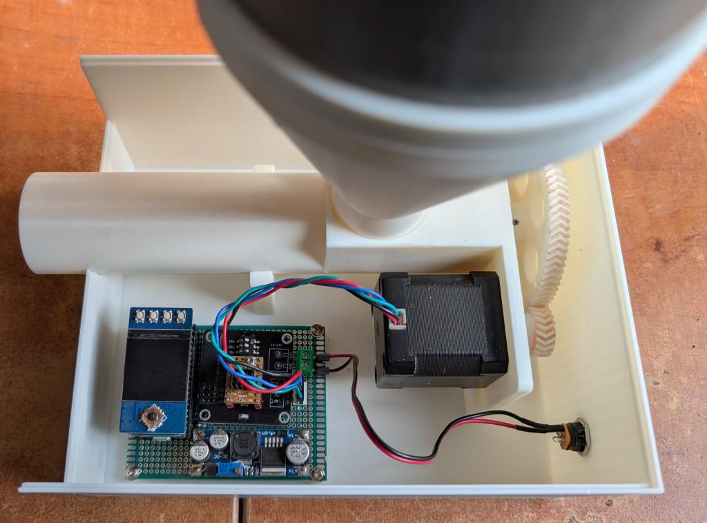

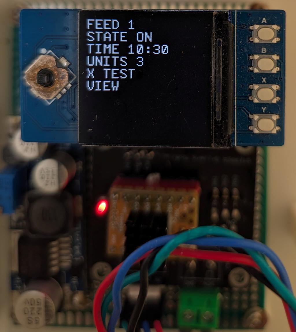

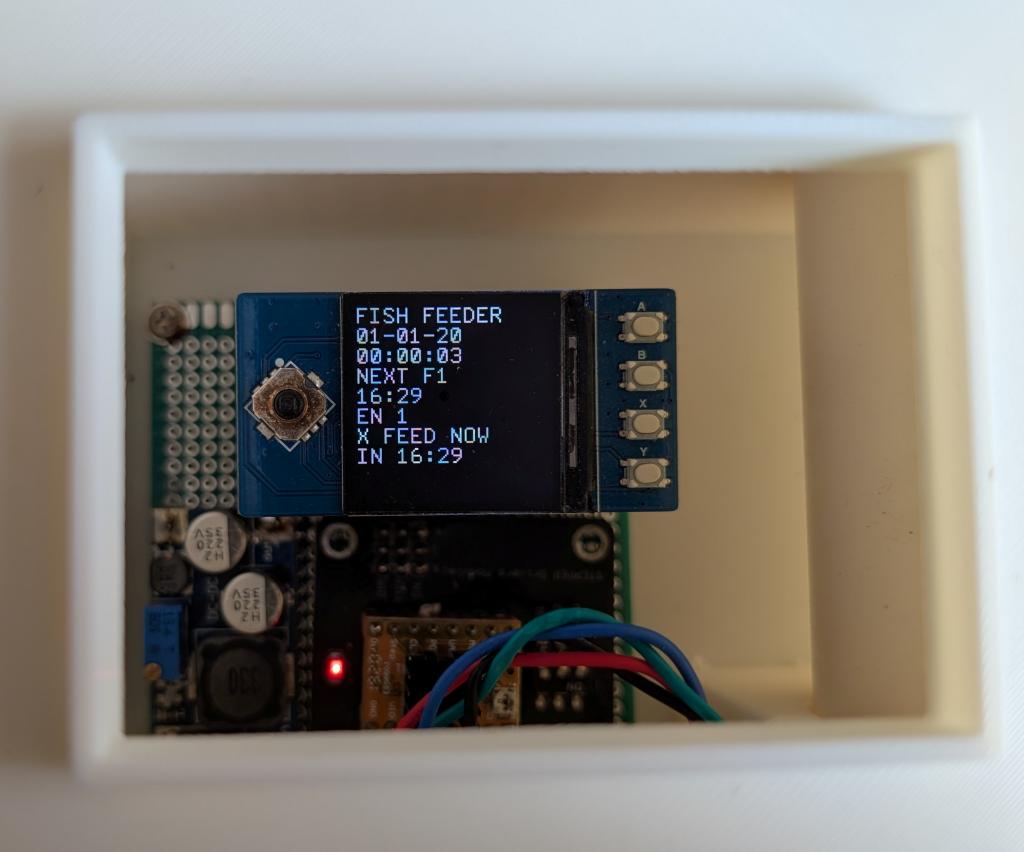

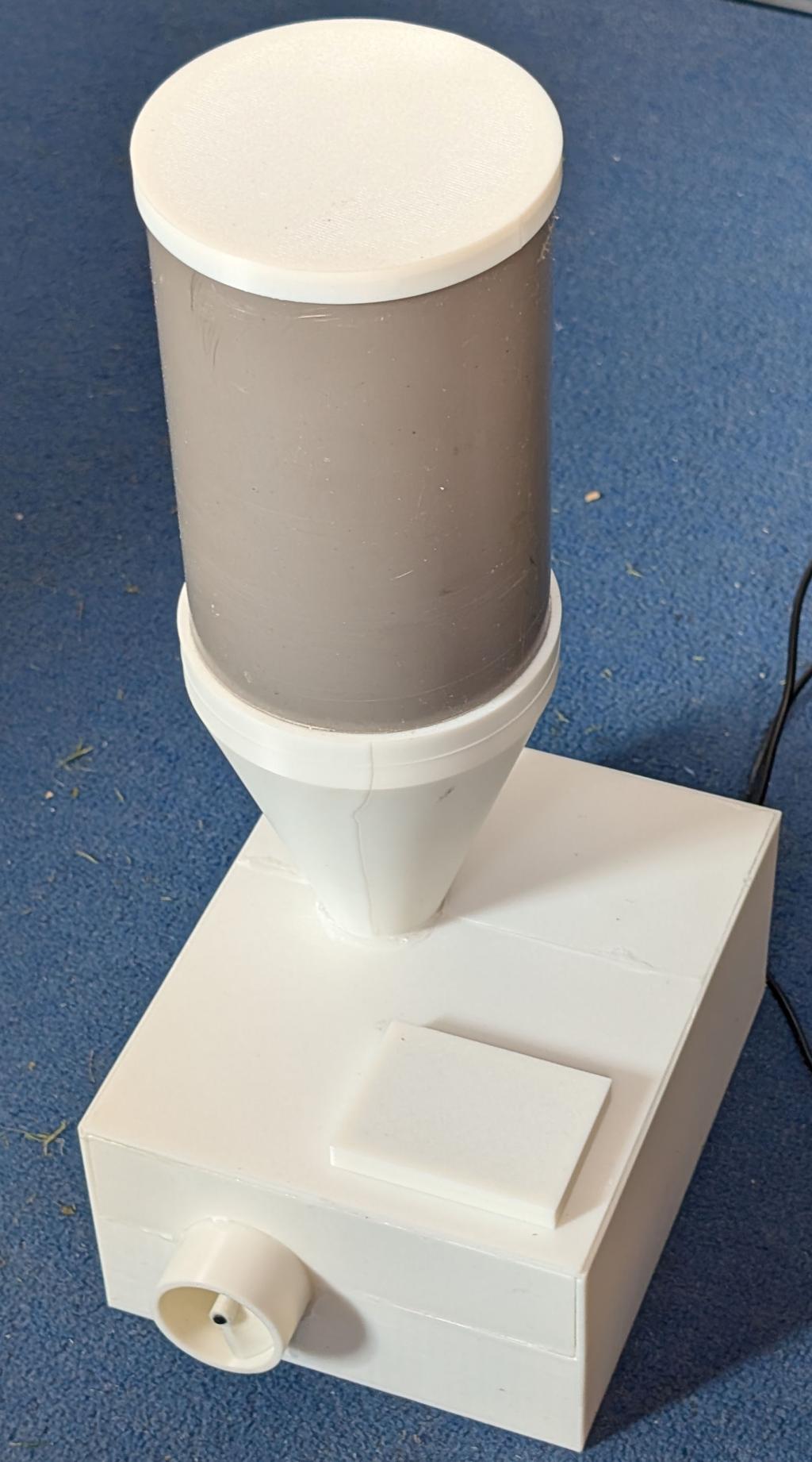

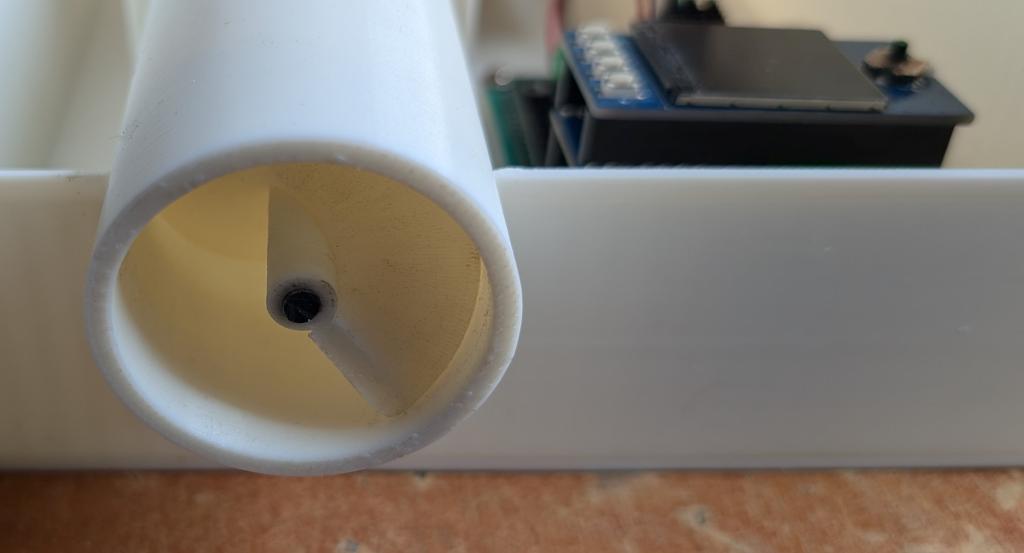

Pico2 + Waveshare RTC + Pico-LCD-1.3 + Stepper driver module + TMC2209 driver
Everything 3D printed. STLs available if anyone wants them. Uses archimedian screw to deliver the food.
Runs with a CPU speed of 48MHz which results in a current draw of about 25mA at 12V so an old car battery should run it for a month easily.

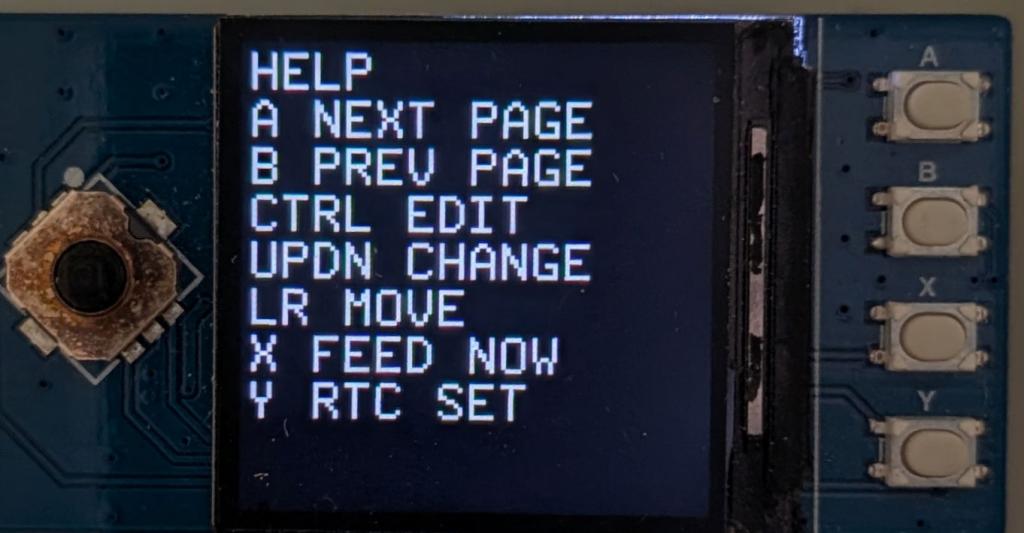

' Navigation:
' A = next page, B = previous page
' CTRL = toggle edit mode on current page
' UP/DOWN = change selected field/value in edit mode
' LEFT/RIGHT = move field selection in edit mode
' X = manual feed now (from HOME page)

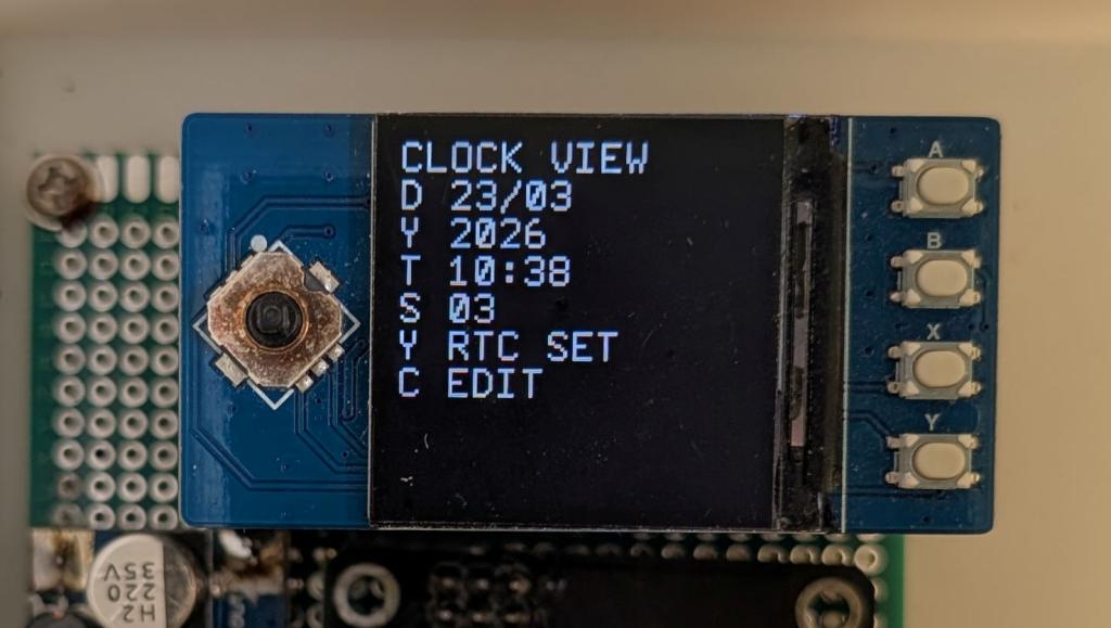

' Y = force RTC SETTIME (from CLOCK page)

 Text 4, 124, "LR MOVE"
 Text 4, 148, "X FEED NOW"
 Text 4, 172, "Y RTC SET"
Sub DrawPrime
 Text 4, 4, "PRIME"
 Text 4, 28, "HOLD X RUN"
 Text 4, 52, "REL X STOP"
 Text 4, 76, "CONT MOVE"
 Text 4, 100, "A/B PAGE"
Sub DrawHome
 Local nexti%, i%, nowMins%, fm%, m%, t$
 Local dMins%, cH%, cM%
 t$ = Time$
 nowMins% = Val(Mid$(t$, 1, 2)) * 60 + Val(Mid$(t$, 4, 2))
 nexti% = 1
 fm% = 24 * 60 + 1
 For i% = 1 To FEED_MAX
   If feedEnabled%(i%) Then
     m% = feedHour%(i%) * 60 + feedMin%(i%)
     If m% >= nowMins% And m% < fm% Then
       fm% = m%
       nexti% = i%
     End If
   End If
 Next i%
 If fm% = 24 * 60 + 1 Then
       fm% = feedHour%(i%) * 60 + feedMin%(i%)
       nexti% = i%
       Exit For
     End If
   Next i%
 End If
 Text 4, 4, "FISH FEEDER"
 Text 4, 28, Left$(Date$, 8)
 Text 4, 52, Left$(Time$, 8)
 Text 4, 76, "NEXT F" + Trim$(Str$(nexti%))
   Text 4, 100, "--:--"
   Text 4, 172, "IN --:--"
 Else
   Text 4, 100, TwoDigit$(feedHour%(nexti%)) + ":" + TwoDigit$(feedMin%(nexti%))
   dMins% = fm% - nowMins%
   If dMins% < 0 Then dMins% = dMins% + (24 * 60)
   cH% = dMins% \ 60
   cM% = dMins% Mod 60
   Text 4, 172, "IN " + TwoDigit$(cH%) + ":" + TwoDigit$(cM%)
 End If
 Text 4, 124, "EN " + Trim$(Str$(EnabledCount%()))
Sub DrawClock
 Local m$, markX%
 markX% = 240 - (3 * MM.FONTWIDTH)
 If editMode% Then
   m$ = "EDIT"
 Else
   m$ = "VIEW"
 End If
 Text 4, 4, "CLOCK " + m$
 Text 4, 28, "D " + TwoDigit$(setDay%) + "/" + TwoDigit$(setMonth%)
 Text 4, 52, "Y " + Trim$(Str$(setYear%))
 Text 4, 76, "T " + TwoDigit$(setHour%) + ":" + TwoDigit$(setMin%)
 Text 4, 100, "S " + TwoDigit$(setSec%)
 Text 4, 124, "Y RTC SET"
 Text 4, 148, "C EDIT"
 If editMode% Then
   Select Case fieldSel%
     Case 0: Text markX%, 28, "<D"
     Case 1: Text markX%, 28, "<M"
     Case 2: Text markX%, 52, "<Y"
     Case 3: Text markX%, 76, "<H"
     Case 4: Text markX%, 76, "<N"
     Case 5: Text markX%, 100, "<S"
   End Select
 End If
Sub DrawFeed(idx%)
 Local m$, en$, markX%
 If feedEnabled%(idx%) Then
   en$ = "ON"
 Else
   en$ = "OFF"
 End If
 If editMode% Then
   m$ = "EDIT"
 Else
   m$ = "VIEW"
 End If
 Text 4, 4, "FEED " + Trim$(Str$(idx%))
 Text 4, 28, "STATE " + en$
 Text 4, 52, "TIME " + TwoDigit$(feedHour%(idx%)) + ":" + TwoDigit$(feedMin%(idx%))
 Text 4, 76, "UNITS " + Trim$(Str$(feedUnits%(idx%)))
 Text 4, 100, "X TEST"
 Text 4, 124, m$
 If editMode% Then
     Case 0: Text markX%, 28, "<E"
     Case 1: Text markX%, 52, "<H"
     Case 2: Text markX%, 52, "<M"
     Case 3: Text markX%, 76, "<U"
   End Select
 End If
Function TwoDigit$(v%)
 TwoDigit$ = Right$("0" + Trim$(Str$(v%)), 2)
End Function
Function EnabledCount%()
 Local i%, c%
 c% = 0
   If feedEnabled%(i%) Then Inc c%
 Next i%
 EnabledCount% = c%
End Function
Function ReadEvent%()
 Local aNow%, bNow%, xNow%, yNow%
 Local uNow%, dNow%, lNow%, rNow%, cNow%
 aNow% = SafeBtn%(a)
 bNow% = SafeBtn%(b)
 xNow% = XPressed%()
 yNow% = SafeBtn%(ybtn)
 uNow% = SafeBtn%(up)
 dNow% = SafeBtn%(down)
 lNow% = SafeBtn%(leftpin)
 rNow% = SafeBtn%(rightpin)
 cNow% = SafeBtn%(ctrl)
 ReadEvent% = EV_NONE
 If aNow% And Not prevA% Then
   ReadEvent% = EV_A
 ElseIf bNow% And Not prevB% Then
   ReadEvent% = EV_B
 ElseIf xNow% And Not prevX% Then
   ReadEvent% = EV_X
 ElseIf yNow% And Not prevY% Then
   ReadEvent% = EV_Y
 ElseIf uNow% And Not prevUp% Then
   ReadEvent% = EV_UP
 ElseIf dNow% And Not prevDown% Then
   ReadEvent% = EV_DOWN
 ElseIf lNow% And Not prevLeft% Then
   ReadEvent% = EV_LEFT
 ElseIf rNow% And Not prevRight% Then
   ReadEvent% = EV_RIGHT
 ElseIf cNow% And Not prevCtrl% Then
   ReadEvent% = EV_CTRL
 End If
 prevA% = aNow%
 prevB% = bNow%
 prevX% = xNow%
 prevY% = yNow%
 prevUp% = uNow%
 prevDown% = dNow%
 prevLeft% = lNow%
 prevRight% = rNow%
 prevCtrl% = cNow%
End Function
Function SafeBtn%(pin$)
 Local v%
 v% = 0
 v% = (Pin(pin$) = 0)
 SafeBtn% = v%
End Function
Function SafePin%(pin$)
 Local v%
 v% = 1
 On Error Skip 1
 v% = Pin(pin$)
 SafePin% = v%
End Function
Function XPressed%()
 XPressed% = SafeBtn%(xbtn)
End Function

circuit

Click the "Stepper Driver" link on the first line of this thread, then click view details.
  Quote  Description
Name: 4988/8825 stepper motor drive module expansion board
Fixed: 3mm
Hole distance: 1400*1400mil (35.56*35.56mm)
Logic voltage: 5V
Input voltage: 12-30V
Port: Number
Interface: direction, enable, speed
Applicable modules: A4988, DRV8825
Note: Please pay attention to the direction when installing the driver module, otherwise the module will be burnt
This product is only an expansion board, does not include 4988/8825 drive modules
Looking at Peter's first photo a "Drive Module" is plugged into the top of that.
