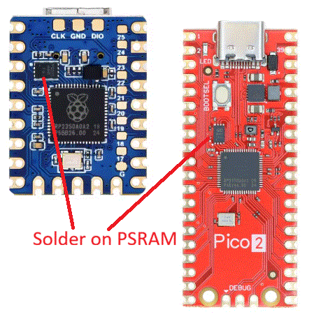

  gadgetjack said  PSRAM ... I stacked it on the flash with the cs line still going to gp47.
Does this mean you can do it with essentially any RP2350 board? Like this?
With CS lifted and wired to GP0?

Well, it's possible because it's been done. It's fiddly though. Personally I prefer to just use a PGA2350 because it's much easier. :)
