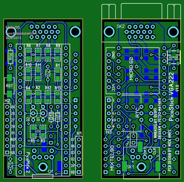

A modification of PicoStick VGA to use the Pico 2 and provide VGA222
As yet this is an untested design. Have fun! :)

Great! A really nice design!
Which microSD module fits?
Can a keyboard and mouse be used simultaneously with the PS/2 port? If not, that would be a great improvement!
Edit:
There are suitable Y-splitter cables with one plug and two sockets available.
Oh, and I forgot to mention: A schematic as a PDF in the ZIP file would be nice.

No, there's no mouse support and nowhere to put two more level shifter channels unless I make things much more difficult to assemble :(
It would be possible to use two of the GPIO pins if you have a PS2 mouse that will run at 3V3.
Micro SD card socket
The circuit was supposed to be there but it got printed to the wrong place and I missed putting it in. Sorry.
Circuit diagram.pdf
The VGA222 firmware doesn't use the VGA121 system, I understand. It uses its own drivers which are controlled using OPTION LCDPANEL. It isn't VGA121 compatible. At least this was the case according to the information I found on the forum, things change so fast that I can't keep up now...  :(
