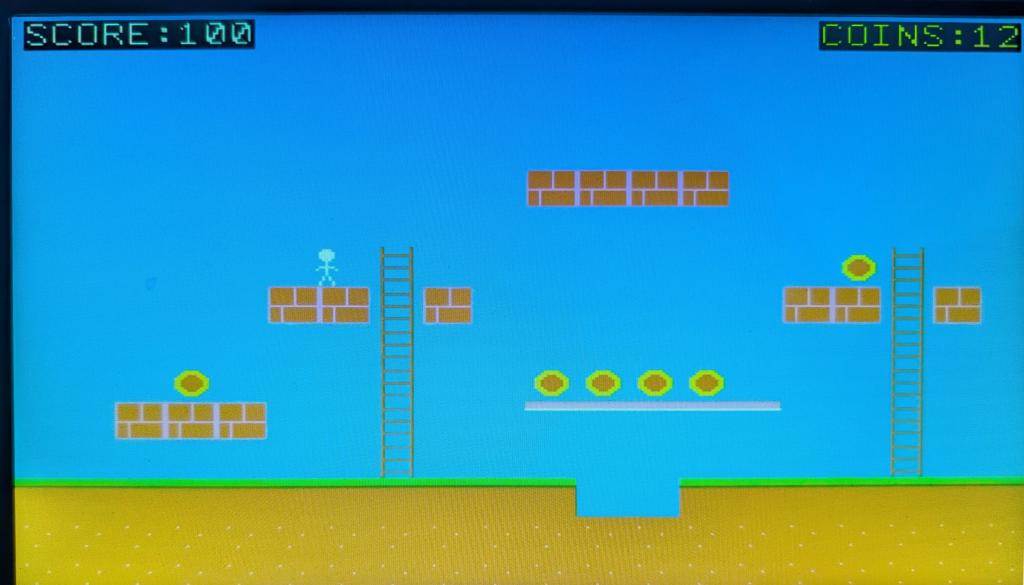

By request, attached is a sort of proforma example platform game programmed using the TILEMAP command. It is fully functional (HDMI or RP2350VGA) and extensively commented so should be useful as a starting point for any sort of platform type game.
' PLATFORM - A Tilemap-Based Platform Game
' A complete reference implementation showing
' how to build a side-scrolling platform game
' using the TILEMAP engine. Techniques covered:

coins_left = 0
FOR trow = 0 TO MROWS - 1
 FOR tcol = 0 TO MCOLS - 1
   hit_t = TILEMAP(TILE 1, tcol * TW + 1, trow * TH + 1)
   IF hit_t > 0 THEN
     hit_a = TILEMAP(ATTR 1, hit_t)
     IF (hit_a AND A_COIN) THEN coins_left = coins_left + 1
   END IF
 NEXT tcol
NEXT trow
' ---- Create player sprite ----
' TILEMAP SPRITE CREATE arguments:
'   1 = sprite ID
'   1 = tilemap ID it belongs to
'   T_PLAYER = initial tile to display
'   x, y = initial screen position
' The sprite moves independently of the map
' and is drawn on top by TILEMAP SPRITE DRAW.
' Start at column 2, row 11 (just above ground).
px! = 2 * TW
py! = 11 * TH
vx! = 0 : vy! = 0
on_ground = 0 : on_ladder = 0
cam_x = 0
anim_count = 0 : anim_tile = T_PLAYER
walk_timer = 0 : climb_timer = 0
TILEMAP SPRITE CREATE 1, 1, T_PLAYER, INT(px!) - cam_x, INT(py!)

 ' ---- Coin collection ----
 ' Check the tile at the player's centre point.
 ' If it has the A_COIN attribute, replace it
 ' with T_EMPTY using TILEMAP SET. This is how
 ' you modify the map at runtime - the tile is
 ' permanently removed until the map is recreated.
 hit_t = TILEMAP(TILE 1, INT(px!) + TW\2, INT(py!) + TH\2)
 IF hit_t > 0 THEN
     tcol = (INT(px!) + TW\2) \ TW
     trow = (INT(py!) + TH\2) \ TH
     TILEMAP SET 1, tcol, trow, T_EMPTY  ' remove coin from map
     score = score + 100
     coins_left = coins_left - 1
   END IF
 END IF

 ' ---- Render ----
 ' Drawing order matters! The tilemap is drawn
 ' first (background), then sprites on top,
 ' then HUD text over everything.
 ' TILEMAP DRAW arguments:
 '   1 = tilemap ID
 '   F = destination (framebuffer)
 '   cam_x, 0 = world pixel offset to start
 '              drawing from (scrolling!)
 '   0, 0 = screen destination position
 '   SCR_W, SCR_H = size of viewport
 '   -1 = draw all layers
 TILEMAP DRAW 1, F, cam_x, 0, 0, 0, SCR_W, SCR_H, -1
 ' Draw all sprites belonging to this tilemap.
 ' The 0 flag means draw at the sprite's current
 ' screen position (set by SPRITE MOVE above).
 TILEMAP SPRITE DRAW F, 0
 ' HUD overlay: score and remaining coins.
 ' TEXT is drawn directly over the tilemap/
 ' sprite layers. "LT" = left-top aligned,
 ' "RT" = right-top aligned.
 TEXT 4, 2, "SCORE:" + STR$(score), "LT", 1, 1, C_WHITE
 TEXT SCR_W - 4, 2, "COINS:" + STR$(coins_left), "RT", 1, 1, C_YELLOW

SUB GenerateTileset
 ' Procedural Tileset Generation
 ' Instead of creating tile graphics externally,
 ' we draw them programmatically using LINE, BOX,

' MAP DATA: 40 cols x 15 rows = 600 tile values
' Row 0 = top of screen, Row 14 = bottom.
' Each value is a tile index (0-8).
' Level design notes:
' - Row 12 is the main ground (grass). Gaps at
'   cols 11-12, 22-24, and 36-37 create pits the
'   player must jump over (or fall to death).
' - Two vertical ladders at cols 7 and 17 connect
'   ground level up through mid-level platforms.
' - A long ladder at col 29 reaches the highest
'   platform (row 3).
' - Ladder tiles REPLACE one brick in each
'   platform row (e.g. row 7 col 7 = ladder tile
'   3 instead of brick tile 2). This lets the
'   player climb through the platform.
' - An EXTRA ladder tile extends one row ABOVE
'   each platform (e.g. row 6 col 7). Without
'   this, the player would be stuck halfway into
'   the platform with no non-solid tile to step
'   off onto.
' - One-way platforms (tile 8) let the player
'   jump up through them from below but stand on
'   them when falling from above.
' - Coins (tile 4) are placed to reward
'   exploration of all routes.
' Legend:
'   0=empty  1=grass  2=brick  3=ladder
'   4=coin   5=sky    6=dirt   8=platform
mapdata:
' Row 0: sky
DATA 5,5,5,5,5,5,5,5,5,5,5,5,5,5,5,5,5,5,5,5,5,5,5,5,5,5,5,5,5,5,5,5,5,5,5,5,5,5,5,5
' Row 1: sky with coins on high platforms
' Row 2: upper platforms (ladder at col 29 extends above row 3 platform)
DATA 5,5,5,5,5,5,5,5,5,5,5,5,5,5,5,5,5,5,5,5,5,5,5,5,5,5,5,5,4,3,5,5,5,5,5,5,5,5,5,5
' Row 3: upper platforms (ladder at col 29 passes through)
DATA 5,5,5,5,5,5,5,5,5,5,5,5,5,5,5,5,5,5,5,5,5,5,5,5,5,5,5,2,2,3,2,2,5,5,5,5,5,5,5,5
' Row 4: sky
DATA 5,5,5,5,5,5,5,5,5,5,2,2,2,2,5,5,5,5,5,5,5,5,5,5,5,5,5,5,5,3,5,5,5,5,5,5,5,5,5,5
' Row 5: mid-level platforms
DATA 5,5,5,5,5,5,5,5,5,5,5,5,5,5,5,5,5,5,5,5,5,5,5,4,5,5,5,5,5,3,5,5,5,5,5,5,5,5,5,5
' Row 6: coins and platforms (ladders at col 7,17 extend above row 7 platforms)
DATA 5,5,5,5,5,5,4,3,5,5,5,5,5,5,5,5,4,3,5,5,5,5,8,8,8,8,5,5,5,3,5,5,5,5,4,4,5,5,5,5
' Row 7: mid platforms (ladders at col 7,17 pass through)
DATA 5,5,5,5,5,2,2,3,2,5,5,5,5,5,5,2,2,3,2,5,5,5,5,5,5,5,5,5,5,3,5,5,5,8,8,8,8,5,5,5
' Row 8: ladder connections
DATA 5,5,5,5,5,5,5,3,5,5,5,5,5,5,5,5,5,3,5,5,5,5,5,5,5,5,5,5,5,3,5,5,5,5,5,5,5,5,5,5
' Row 9: lower platforms with coins
DATA 5,5,5,4,5,5,5,3,5,5,4,4,4,4,5,5,5,3,5,5,5,5,5,4,5,5,5,5,5,3,5,5,5,5,5,5,5,5,5,5
' Row 10: lower level
DATA 5,5,2,2,2,5,5,3,5,5,8,8,8,8,8,5,5,3,5,5,5,8,8,8,8,5,5,5,5,3,5,5,5,5,5,5,5,5,5,5
' Row 11: near ground
DATA 5,5,5,5,5,5,5,3,5,5,5,5,5,5,5,5,5,3,5,5,5,5,5,5,5,5,5,5,5,3,5,5,5,4,5,5,5,5,5,5
' Row 12: ground level (main floor with gaps)
DATA 1,1,1,1,1,1,1,1,1,1,1,0,0,1,1,1,1,1,1,1,1,1,0,0,0,1,1,1,1,1,1,1,1,1,1,1,0,0,1,1
' Row 13: underground
DATA 6,6,6,6,6,6,6,6,6,6,6,6,6,6,6,6,6,6,6,6,6,6,6,6,6,6,6,6,6,6,6,6,6,6,6,6,6,6,6,6
' Row 14: underground
' TILE ATTRIBUTES (12 tile types)
' One attribute value per tile type (1 through
' 12), read sequentially by TILEMAP ATTR.
' Each value is a bitmask. TILEMAP(COLLISION)
' tests attribute bits to determine what kind
' of tile the player overlaps:
'   bit 0 (1) = A_SOLID  - blocks movement
'   bit 1 (2) = A_LADDER - enables climbing
'   bit 2 (4) = A_COIN   - collectible item
'   bit 3 (8) = A_PLAT   - one-way platform
' Sprite-only tiles (9-12) have attribute 0
' since they never appear in the map.
tileattrs:
DATA 1      ' tile 1: grass    - A_SOLID
DATA 1      ' tile 2: brick    - A_SOLID
DATA 2      ' tile 3: ladder   - A_LADDER
DATA 4      ' tile 4: coin     - A_COIN
DATA 0      ' tile 5: sky      - passable
DATA 1      ' tile 6: dirt     - A_SOLID
DATA 0      ' tile 7: player   - none
DATA 8      ' tile 8: platform - A_PLAT
DATA 0      ' tile 9: walk 1   - none (sprite only)
DATA 0      ' tile 10: walk 2  - none (sprite only)
DATA 0      ' tile 11: climb 1 - none (sprite only)
DATA 0      ' tile 12: climb 2 - none (sprite only)
