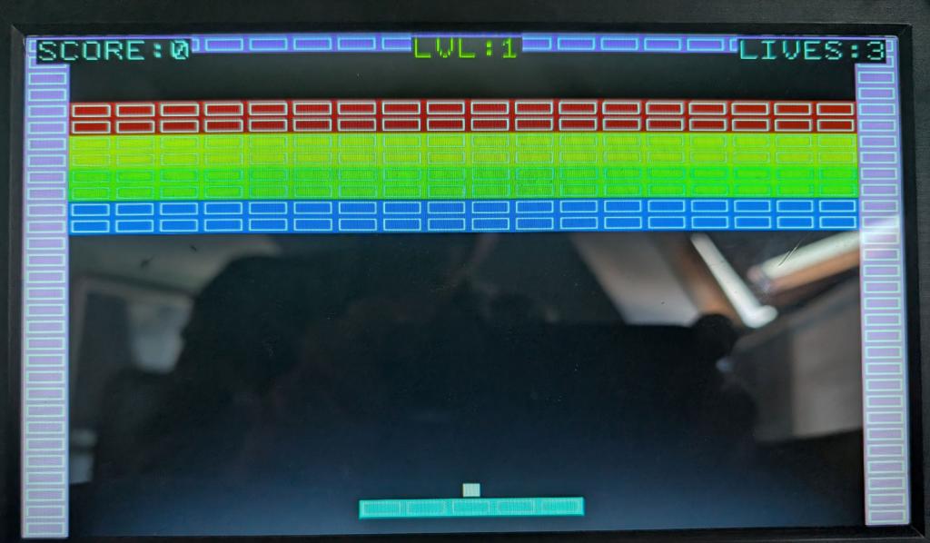

For RP2350 VGA or HDMI.
You need to use a local keyboard and set the keyboard repeat as low as possible.
This game was  written by CLAUDE 4.6 and took 10 minutes to write with 5 iterations to remove syntax and logical errors.
The obvious update would be to support a gamepad or wii controller - should also be easy enough to port to the Game*Mite and use the buttons.
Not thoroughly tested as I'm crap at games.
' BREAKOUT - A Tilemap-Based Brick Breaker
' Uses TILEMAP for the brick field and
' TILEMAP sprites for the ball and paddle.
' Procedurally generates tileset BMP.
' Controls: Left/Right arrows to move paddle
'           Space to launch ball
'           Q to quit
' Requires: MODE 2 (320x240 RGB121), SD card

Joined: 20/09/2024
Posts: 924
Posted: 07:07pm 11 Mar 2026
Beautiful and sad at the same time. Those who are not ready to use AI can leave.
Edit:
The ball moves smoothly and the angles you can achieve are just as good as on other platforms I've played before. In my opinion, the movement of the racket needs to be improved. The speed is good, I had the patience to finish level 1 with the original settings, but on my second attempt I set the ball speed to 1.2 and the racket to 30.
Tested on the latest RC3 and ILI9341 LCD.
Edit2: Naive question, is it possible to tell this Claude to look into this for example and port it?
Edited 2026-03-12 08:04 by dddns

 CLS C_BLACK
 ' Tile 1: Red brick
 tx = 0 : ty = 0
 Box tx, ty, TW, TH, 0, C_RED, C_RED
 Box tx+1, ty+1, TW-2, TH-2, 1, C_WHITE
 ' Tile 2: Yellow brick
 tx = TW : ty = 0
 Box tx, ty, TW, TH, 0, C_YELLOW, C_YELLOW
 ' Tile 3: Green brick
 tx = TW * 2 : ty = 0
 Box tx, ty, TW, TH, 0, C_GREEN, C_GREEN
 ' Tile 4: Blue brick
 tx = TW * 3 : ty = 0
 Box tx, ty, TW, TH, 0, C_BLUE, C_BLUE
 ' Tile 5: Wall (grey border)
 tx = TW * 4 : ty = 0
 Box tx, ty, TW, TH, 0, C_GREY, C_GREY
 ' Tile 6: Ball (white square on black)
 tx = TW * 5 : ty = 0
 Box tx, ty, TW, TH, 0, C_BLACK, C_BLACK
 Box tx+TW\2-3, ty+TH\2-3, 6, 6, 0, C_WHITE, C_WHITE
 ' Tile 7: Paddle segment (cyan)
 tx = TW * 6 : ty = 0
 Box tx, ty, TW, TH, 0, C_CYAN, C_CYAN
 ' Tile 8: Paddle left (same as paddle for now)
 tx = TW * 7 : ty = 0
 Save IMAGE "breakout_tiles.bmp", 0, 0, TPR * TW, TH

Posts: 6195
Posted: 12:02pm 12 Mar 2026
Peter,
Error in line 126, cannot change a constant.
Posts: 12056
Posted: 12:09pm 12 Mar 2026
Change line 84 to dim float, sorry pasted the wrong version
I got 1286. Level 3 get quite fast
Edited 2026-03-12 22:26 by matherp
Posts: 6195
Posted: 01:06pm 12 Mar 2026
Peter,
I had to reconstruct some lines, since in above listing they where cut off.
But after that it runs fine.
I may have to look at integration into the GM menu (i.e. at exit RUN "menu.bas" and not END) and such (select is QUIT, START to start a game).
But it is a nice game. Runs smooth.
Finetuning:
- press SPACE to restart....(space??)
- color Grey does not exist in framebuffer land. Shows as pink.
- next version publish as ZIP (no cut off lines).
Edited 2026-03-12 23:13 by Volhout
