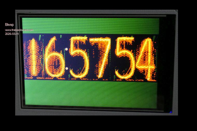

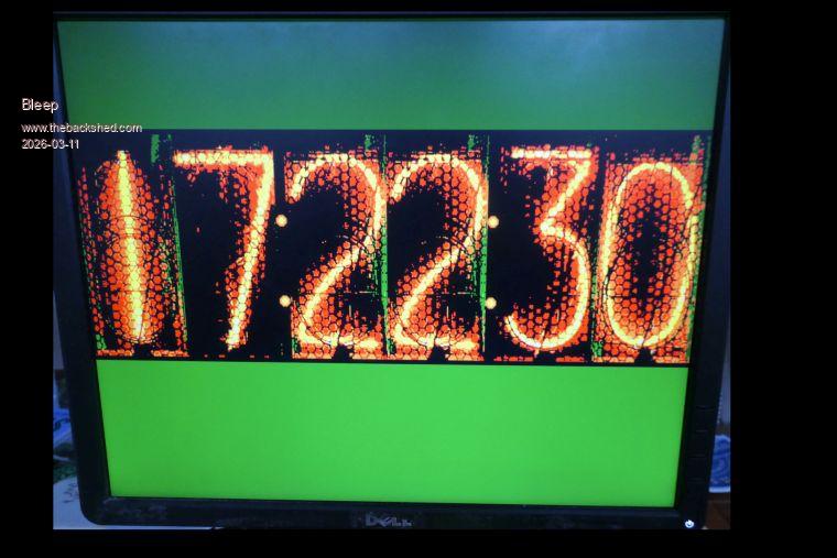

Hi,
Here is my take on a Nixie Clock for a PicoMite, Both for a 480x320 LCD and a HDMI VGA, It might be ok on a standard VGA, I have not tried it, I have also not tested it on a 2040 Pico.
VGA Version
Short video of it working.
LCD Version
Short Video of it working.

In the jpg file, all the digits look fine but when the program runs, the 4 and the 9 don't display properly in the minutes column.

When you say the 4 & 9 don't display properly, what exactly do you mean?
What picomite are you using? You do realise this will only work on a HDMI VGA or a 480x320 LCD & not tested on a RP2040 which may not have enough memory.

Hi Kevin
Looks realy good on HDMI,  but will not run on 2040 (no Mode 3)
So you can lower the resolution to 320x240 (Mode 2) reduse your source to BW (mode 1)
Good Job

Hi Martin,
I can try re-sizing to fit 320x240, but I think the images will become too small, one option might be to only show Hours & Minutes.
While you are here, on a LCD The JPGs are full colour, and I am placing the Jpg of the Nixie tubes on to a Framebuffer layer, but they are limited in colour range, do you know, if I put the JPG onto the normal screen temporarily, then copy each digit to BLIT buffers, assuming there is enough memory, which I think there is not, do the BLIT buffers have a higher colour count, ie same as the screen in use, or they similarly colour depth limited. Thanks.

Kevin
I reduced the template by half, so it should fit in Mode 2. See which version you like better.

Attached is a new version of the VGA Mode 2 320x240 Nixie Clock, using your images, both sets are in the code, just change the commented out line. I couldn't use the PNG directly, not enough memory, so I changed them to BMP.
I have included my 3 Nixie sets, as JPG, could you let me know how and what programs you use to reduce the colours to less than 16, and using the 121 colour set? also is it possible to reduce the brightness/contrast, so there are fewer random orange dots around/in the converted image?

I just tried it, but unfortunately it doesn't work on the  standard 2040 VGA...
[19] Blit Read 6,0,110,51,110
Error : Not enough Heap memory
You could work around this by,instead of storing the numbers in sprites, initializing the framebuffer first, load the Image there and then blitting the segments from the framebuffer F to  N.
