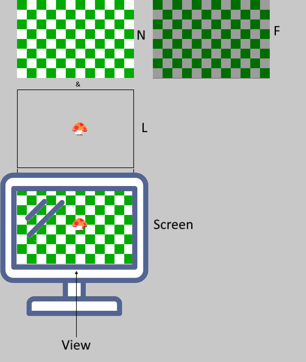

Here is a more detailed explanation.
All graphic commands work on N F and L, depending on what you previously selected with the FRAMEBUFFER WRITE command.
Your normal screen is N
If you have not set anything else, all outputs will take place here.
The optional framebuffer F
is a hidden image memory that you can work on, but it is never displayed. However, you can copy its contents from and to N or L. This is useful for setting up a flicker-free image build-up by always working on F first and then copying the result to N (or L).
The optional layer L
plays a special role. It is like a pane, placed over the screen (N). It has the ability (like Sprites) to be partially transparent, making it suitable for displaying objects or placing them over the visible screen without changing the content of N.
So you create your background on N and move your sprites over layer L without having to worry about your background.
However, since the Pico has limited memory, it is advisable to use layers or frame buffers with care. Only use them when you really need them.
I hope that makes sense.
This all applies to Picomites with VGA or HDMI.
PicoCalc uses an LCD for output. The function differs slightly here. To display F and L on the display, you have use the FRAMEBUFFER COPY or FRAMEBUFFER MERGE command.
For more detailed information, please refer to the manual  page 77,78.
