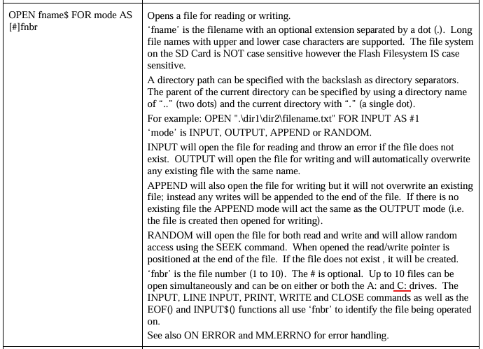

Notes on MMBasic BASIC Interpreter Ver 6.02.00 - manual
maybe change to  B:
/Peter63
Posts: 3416
Posted: 07:24am 07 Mar 2026
Presumably the last sentence of the first paragraph will also be updated, as A: is no longer case sensitive.
