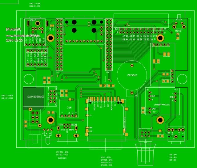

I was inspired by the new WeAct board so I thought of this. I probably won't build it myself, but if anyone wants the gerbers I'll finish the development off.
The Adafruit DVI breakout board appears to *just* fit between the connectors for the WeAct. I can't verify this as I haven't got a WeAct module. It saves having to solder an HDMI socket though. :) There's nothing on the edges of the module, you could take a bit off each side with a file or something.
You get a dim red "standby" LED while it's off and a user-controlled green one while it's on.
You can build it in two ways:
USB (the default) - Power is supplied via the CP2102 module, which is also the terminal connection. The USB-C on the WeAct is for an external passive USB hub.
STND - using standard HDMI firmware. A PS2 keyboard socket is fitted instead of the CP2102 module and power is supplied via the USB-C on the We-Act.
There's a proper socket for a WII controller, but the USB version could also use USB controllers.
The board is designed to fit the cheap Hammond RM2015 enclosure, like a small CMM2.
This is only an idea at present.

Can you measure the distance between the sockets on the WeAct if you have one? It would be interesting to see if I've estimated correctly. :)
I really need to check that it works out vertically too. It should do.
Oh, one other thing, there's no Line Out for audio, only headphones. A resistor (which can be disconnected) mixes some of the left and right channels to form a more central image. I just hope the audio section is quiet enough! The problem is that all the audio modules have the gain far too high by default. In this case we need hardly any gain.

It appears to be an interference fit in the gap! I think I'd recommend just sanding a touch off the outer edges of the Adafruit module, just to allow for tolerances in the thickness of the connectors and solder joints. It won't weaken the module in any way.

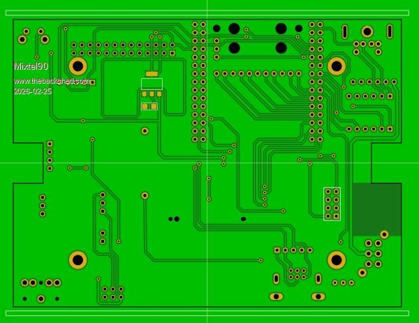

I'm still playing with the design a bit. I've been changing the power arrangement so that the power button works properly in both PS2 and USB modes. Increased the size of the regulator heatsink area a bit. Quite a bit of trace tidying and added component values. Added I2c pullups. Made 4 of the resistors through-hole in case someone wants to do some testing of different values. Quite a bit now I look back on it. :)
The circuit diagram is still all in my head. Nothing written down.
Gerbers shouldn't be long now. I need to have a further visual check (it helps to turn off the ground planes, I find), do a DRC and put mask on the vias yet. Just a bit more text, including the options settings, too.

Posts: 9238
Posted: 08:07pm 25 Feb 2026
The standby LED brightness
Left-right blending for the headphones
Left and right maximum audio level for the headphones
The LED brightness will depend on your LED sensitivity
The left and right max audio level will also give a bit of control over the balance for people like me who are deaf in one ear
The audio blend is a personal thing. There is the option of disconnecting the resistor with a jumper too now.

I've been getting the BOM and a bit of a manual together, while doing final tweaks to the board. Currently I'm doing the circuit diagram - which comes in handy if something doesn't work. :)
The board is, providing I don't find any errors while doing the circuit, probably done now. There have been changes to the layout to, hopefully, minimise noise on the audio. You can also select two different crossfeed levels or none using a jumper. Better than solder blobs here.
