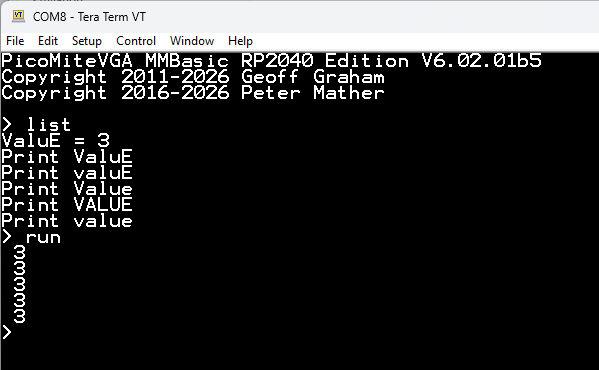

The only thing that is case sensitive is filenames on the A: drive which is a function of the LittleFS file system

Just tried mmb4l and it behaves as expected (case insensitive variables).

Thanks for the reply matherp and JohnS. That is exactly what I expected to happen. I was battling with this all yesterday when it refused accept anything but the defined variable spelling. I tried your example and it worked then I thought perhaps the  OPTION SPECIFIC at the head  of my program made it case sensitive. I disabled that and  it worked so I replaced OPTION SPECIFIC and it continued to work!!! I give up as long as it works.
