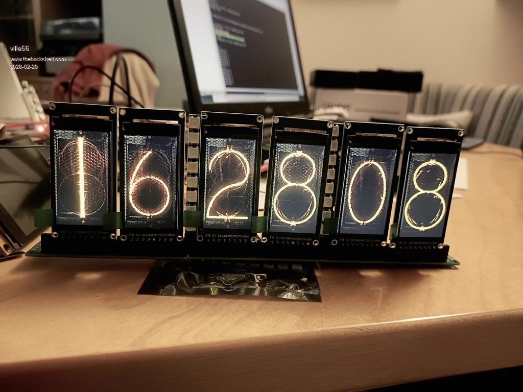

I'v managed to control 6 LCD displays based on ST7789 to simulate good ole Nixie tubes. This is done by simply de-muxing the CS signal for each display, all other singnals are tied as a bus. The only odd thing is that the reset line must not be connected to the Pico, just left open or high. Init is done by selecting the individual displays CS and issuing GUI RESET LCDPANEL. After that just select the required LCD CS and display the content. Have to let it run for a while now, just to see if there are issues ....

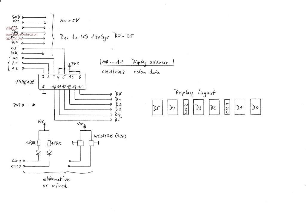

See if they have the ST7789 controller on board. I've only tested this controller to work in the multiplexed setup. As demux decoder I use a 74HC138 for the CS signals. On thing to consider also is, the display has a geometry of 320x160 pixel, but the small side (160px) has an offset of 35, so the coordinate range is from 0,35 to 320,195. Otherwise there is no difference. The MMBasic driver I use is ST7789_320 in portrait mode. To load the images I use BLIT LOAD / BLIT WRITE / BLIT CLOSE for speed reasons. Preloading the 10 images into BLIT buffers, which would have been even faster, did not work, it caused hangs if more than 3 buffers were used. And important, leave the RESET signal of the displays unconnected or tied to HIGH. With reset connected to the signal from the pico it doesn't work. Seems as the controller does listen to RESET even if his CS is inactive. So maybe to be on the safe side RESET could be asserted by an extra output pin at startup. Didn't and have no issues so far.
My display board is a rats nest created with Vero wire, so my initial fear of having distorted CLK and SDA was unneccessary. The other signals are more or less "slowly moving DC" and have not been of concern to me.

A truly unique project. Simply ingenious! Would you be willing to publish the source code? I've already ordered the displays (the price is very reasonable). The circuit itself shouldn't be too complex. However, I have a question about the picture you posted. I see power LEDs behind the "Nixie tubes." Is that related to your circuit (backlighting)?
I'm currently loading your Nixie digit images from an SD card every second and displaying them on a 320x240 display. Just to see how it looks. And I have to say: it's really realistic.

sure I can post the source but I'm far from finished. So far it only displays the result of TIME$ every second, no RTC module, no DCF77, no GPS or NTP access and the comments need some enhancements too to make it readable. Currently I'm tinkering with a 3D printout for masking the displays and colons. The mechanics part is always the hardest part for me.
My plan is to have it running on a WebMite 2 using the NTP service. Same as my kitchen clock I built some time ago. Currently it runs on a WeACt RP2350B module for development, but changeing it to WebMite with NTP should be easy given I don't run into other problems like memory or so which I do not expect at the moment.
The LEDs you see are WS2812B strips with 10 leds on it for the colons. Wanted to make the blinking colons as close as possible to the colors of the nixie tubes. The problem is that the leds are much too bright compared with the LCD displays and dimming the down to an acceptable level did result in disturbed color impression. Was thinking about masking them with a (grey) filter but did not find something in my pool of fancy stuff yet. So I changed to simple yellow leds for the colons for now, with PWM brightness control. But they are still interchangeable with the WS2812 as all display stuff is mounted on a socket row and the code for them is still in.
If you want the circuit I'm using I can post a scan of my schematic after I've updated it. And yes, it's quite simple just the 74HC138 for the CS signal. This would also match the the code then (pin-numbers in the code and signals in the HW).
