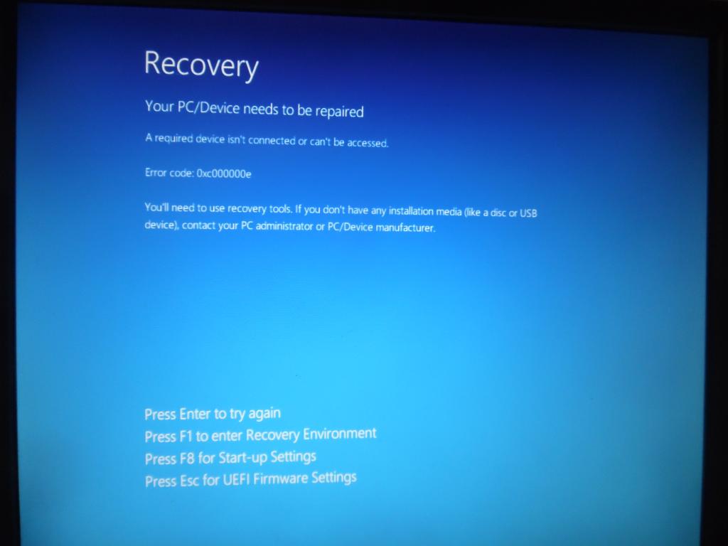

When trying to boot from usb bootable using power tapping F2 or F12 get this each time.
life's too short. pc duff. only £70 dell inspirion small desktop pc.
can't boot Hiren win 11 boot usb

So are you getting into the BIOS? That screen isn't it.
Tapping F2 or F12 while booting should do that. You can also try Fn+F2 and Fn+F12. It's almost always just F2 for Dell.
Once in the BIOS you can start to make the changes that you need to prevent Windows from taking over during boot.

my guess would be press ESC as the UEFI firmware should be what we used to call BIOS

An error like that makes me think that the HDD might be disconnected or even missing! It's what you get when Windows is corrupted and can't start.

F1 is probably a DOS/PowerShell, I'd avoid it except I might use
powercfg /h off
if it'll let you.
F8 might be useful
Esc looks most useful, I'd try that and then try to set your USB to boot first so you can boot Linux from a USB stick.
And turn off fastboot if it has it.
Posted: 09:11pm 18 Feb 2026
I got it to load. The idea was make the usb bootable with etcher or rufus then press F12 on boot and should boot from usb not internal C: ssd.
F12 worked eventually with boot from usb option.
