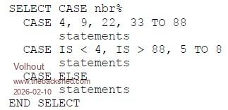

Alternatively use SELECT CASE
Similar to this (from the manual)
