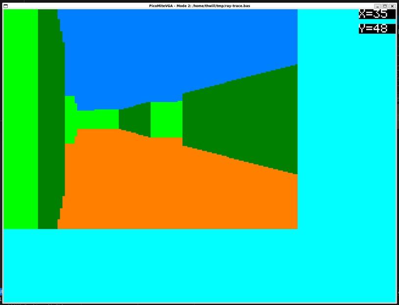

A screenshot for those who are interested, but not enough to crank up the 'Mite:
Generated by MMB4L running under WSL2 on Windows whilst simulating a PicoMite .
Edited 2026-02-09 20:49 by thwill

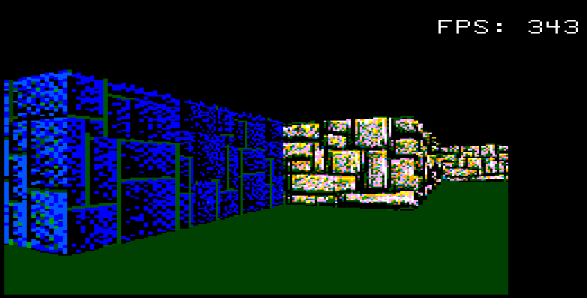

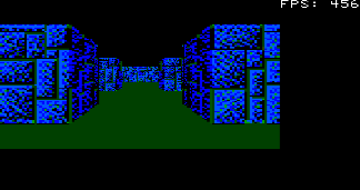

How about this ? - -worth including in the RP2350 firmware?
Manual:
Raycaster_User_Manual.pdf
Example code:
  Quote  ' ============================================================
' Raycaster Demo for PicoMite MMBasic (RP2350)
' Continuous auto-play loop with animated sliding door
' Demonstrates: RAY MOVE, RAY TURN, RAY CELL, RAY CAST,
'               RAY SPRITE, RAY MINIMAP, RAY DOOR
' Press ESC at any time to quit
Option EXPLICIT
MODE 2
CLS
' ---- Map dimensions ----
Const MAP_W = 57
Const MAP_H = 51
Const FOV = 66
' ---- Start position ----
Const START_X = 25.5
Const START_Y = 23.5
Const START_A = 0
' ---- Variables ----
