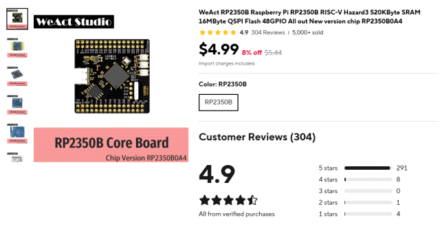

This looks like a good base for projects which don't try to replicate Peter's excellent 64-pin DIL PCB.

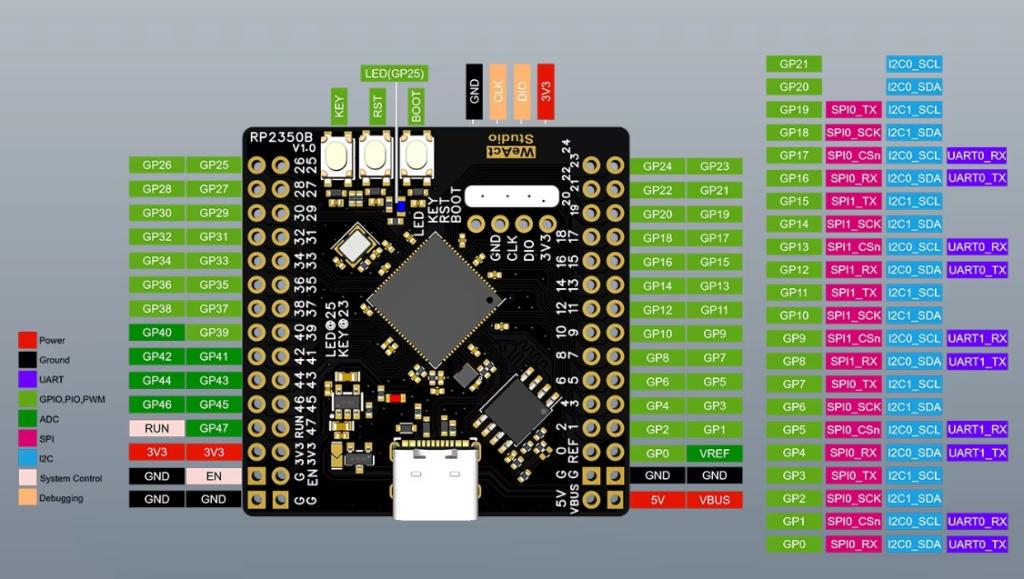

With the USB connector down, the right 2 rows of pins effectively replicate the Pico 1 pins, with their respective functions.
$4.99USD if 3 purchased from Aliexpress:

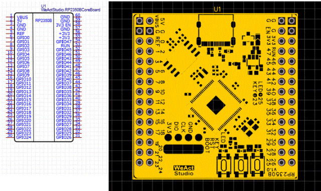

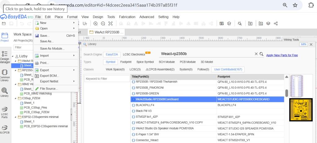

The EasyCad footprint is available in the Standard (not Pro) version under "User Contributed" as WeActStudio.RP2350BCoreBoard (I couldn't find it under Pro):
In EasyCAD:

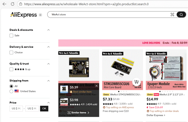

It's weird. This takes me to where the module is one of many:
https://www.aliexpress.us/w/wholesale-WeAct-RP2350B-.html
When I click on it, it takes me to a "Dollar Express" page on which it is also one item of many.
When I click on that, I can order the module (but I never get to a page on which I can see specifications).
I've ordered 3 of them.

This gets me to the store, and the module is there, but clicking on it still takes me to a "Dollar Express" page where I can click on the module and order, but not a typical Aliexpress item page:
https://www.aliexpress.us/w/wholesale-WeAct-store.html
It does make me wonder if this is a module which will continue to be produced.
Edited 2026-02-06 00:17 by lizby

  Mixtel90 said  I'm getting a "Love Delivers" page, not a WeAct page. It lists several WeAct items but they are all STM32, CANFD, Mini Debugger and ESP32. Not much WeAct and no WeAct RP stuff at all.
Yes, the page I get is "Love Delivers", but the RP2350 is the upper leftmost item:
If I click on that, I get the "Dollar Express" page which also has the module (among others), and if I click on that, I can order it.

You are ok just bringing the ADC signals straight out. Try to keep them away from noise such as the 5V rail and video signals if you can. If you can't then try to cross them at right angles on the other side of the pcb. I like to run a direct GND from the closest connection on the module with them so that you aren't sharing an ADC ground with anything else. Note that GP47 is used for PSRAM_CS on some modules by default and you may need to make changes if you want all 8 ADC channels.

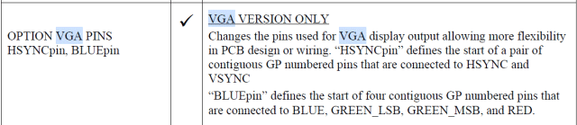

Per the Picomite manual for setting alternate VGA pins:
Would this apply to the upper pins of this module, e.g., GP27, 28, 29, 30 for blue, green1, green2, and red?
Edited 2026-02-08 04:41 by lizby
Posts: 9081
Posted: 06:50pm 07 Feb 2026
I think I might have tried it at some point. It will probably work. AFAIK there's nothing special about the VGA pins apart from the fact that they have to be consecutive. There's no special internal hardware like there is for DVI/HDMI.
