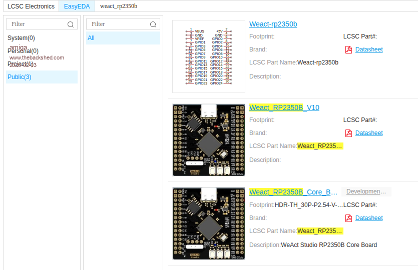

Posted: 01:06am 03 Feb 2026
  amiga said
  Volhout said  The WeAct RP2350B 16MByte QSPI Flash 48GPIO is a nice board
board very cheap , i use it as piggyback on a very simple pcb with only connector,some smd resistor,capacitor and lot of JST XH 2.54mm Connector . Waiting order from Ahhhli . and pcb from JCLPCB
alfamiga
The WeAct RP2350B 48GPIO looks like a very good board to build out from. Can you share a picture of your PCB layout (e.g., from JLC's orders page)?
Did you get JLC to make a footprint for the module? They will do that.  Or was one available for, say, EasyCAD? I'll ask them if you haven't--unless you'd like to go ahead and ask them.

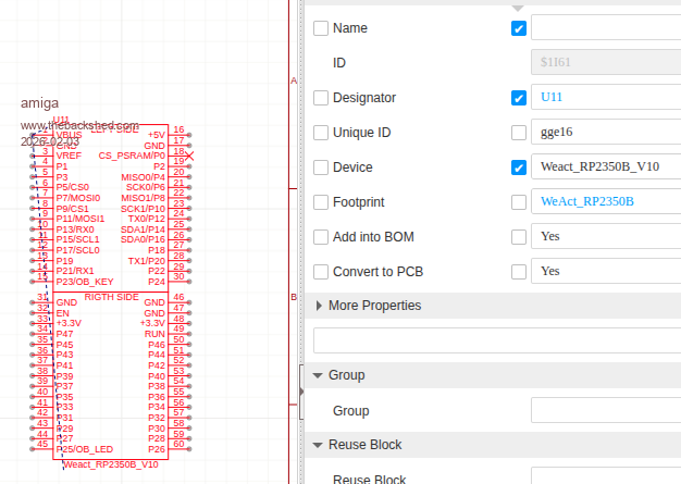

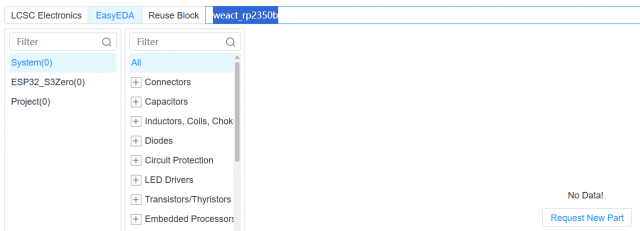

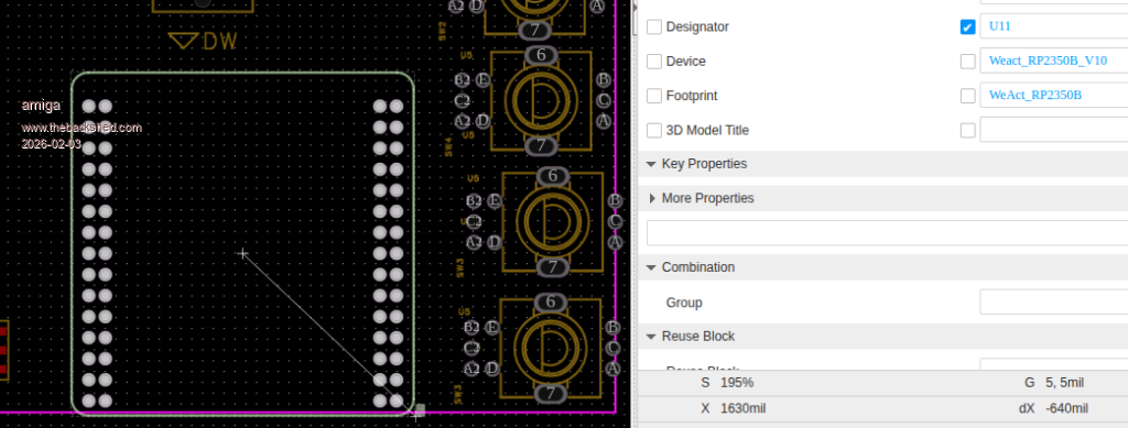

amiga
Joined: 08/05/2025
Location: Belgium
Posts: 53
Posted: 09:14am 03 Feb 2026
  lizby said
alfamiga
hi ,
i use easycad pro , in schematic the layout is ::

  amiga said  i use easycad pro , in schematic the [WeAct] layout is ...
Thank you. Super. That's only the outer pins, though, isn't it? Or is the V10 device the one to use for all pins?
A question for Peter (or anyone): what does 16MB PSRam do for us on this WeAct module?
[In EasyEDA Pro, I'm not finding the part. Any clues on how to look?
Edited 2026-02-04 00:46 by lizby

it's the version of the pico 2 (chip RP2350B0A4) not compatible picomite or buggy silicon?
after some optimisation due to the form factor (100mm*100mm) for jclpcb i shrinked my new version to 28 gpio .. in this case i have more choice for the pico 2 boards, but wich chip version with less buggy?
