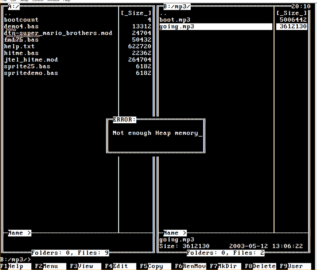

Does anyone else have this problem with MP3 playback from the FM175? It used to work without any problems.
It also works when I start playback from the prompt.
> option list
PicoMiteHDMI MMBasic USB RP2350A Edition V6.02.00
OPTION SYSTEM I2C GP20,GP21
OPTION FLASH SIZE 4194304
OPTION COLOURCODE ON
OPTION KEYBOARD GR
OPTION RESOLUTION 640x480 @ 315000KHz
OPTION SDCARD GP22, GP26, GP27, GP28
OPTION AUDIO GP10,GP11', ON PWM CHANNEL 5
OPTION RTC AUTO ENABLE
OPTION MODBUFF ENABLE  192
OPTION PLATFORM HDMIUSB

Note on MP3 playback:
MP3 playback uses a LOT of memory. At the command prompt play an mp3 file and then type MEMORY to see how much. Prior to 6.02.00 it took a lot of that memory off the system stack. This caused repeated issues with complete crashes of the PicoMite environment if the stack corrupted other memory. In 6.02.00, the code has been changed so the memory is taken from the MMBasic heap. This allows for a graceful error "Not enough heap memory" rather than a system crash. The overall memory usage is the same. If you see this error in a program you will need to reduce other data structures to free up enough memory for mp3 playback. Previously, your code might have worked but hidden data was probably being corrupted leading to undefined errors.

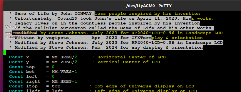

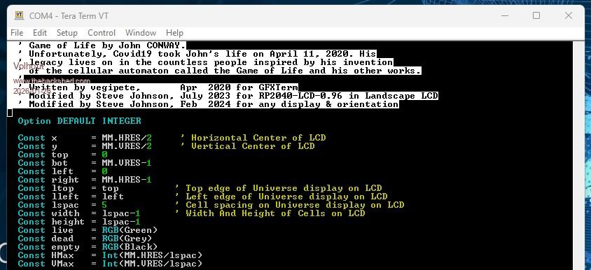

Posted: 09:46am 26 Jan 2026
@Peter,
The change in the editor does not work out well for the Linux Putty combination.
It works well for Windows Teraterm.
See below.
Highlighting with F4 in TeraTerm. Works fine.
Highlighting with F4 in Putty/Linux. At press of F4 the text is shifted up two lines, then highlighting happens as if text was not shifted up.
Edited 2026-01-26 19:47 by Volhout
Posts: 12056
Posted: 09:49am 26 Jan 2026
You will need to find whatever setting is needed to overcome this. Probably inferring CR from LF or something like that.
Fresh install of putty works perfectly on windows
Edited 2026-01-26 19:52 by matherp
