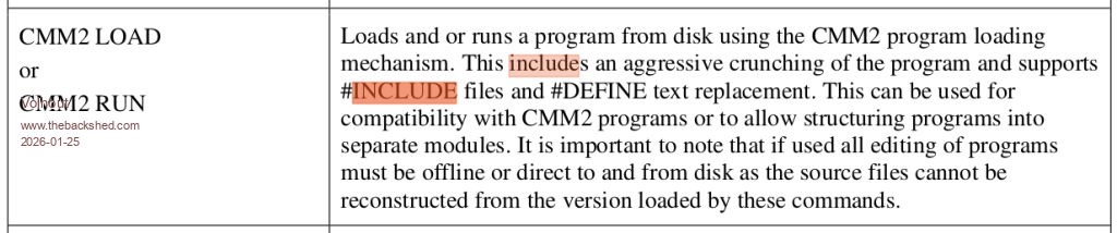

Posted: 02:27pm 25 Jan 2026
  Volhout said  Never tried it [#include]. But...
I tried it, it didn't work, and I posted a question about it quoting that CMM2 LOAD text from the Picomite manual. Peter explained that it did only work with CMM2 LOAD, which (as the manual says), strips out comments and white space.
