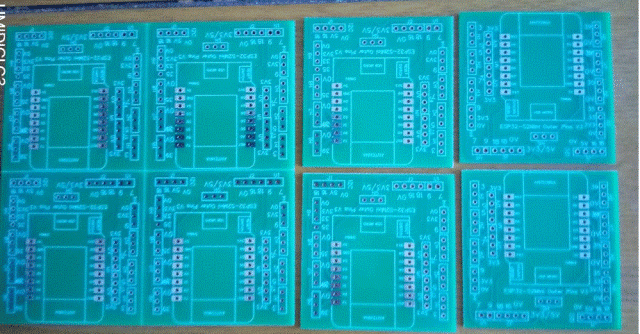

20 PCBs (4 boards, 4 snappable PCBs each) for $12.08 USD total including shipping.
This is a board for the outer pins of the ESP32-S2Mini I used a footprint for the ESP8266 D1 Mini which has the same pins, but differently labelled. The pin numbers on the breakouts around the edges are correct for the S2Mini.
I specified the 2x2 layout, and checked the v-groove box. Everything came out as hoped, even though the JLCPCB page for the order only shows a single instance (and doesn't say they are ganged). They snapped apart easily.
