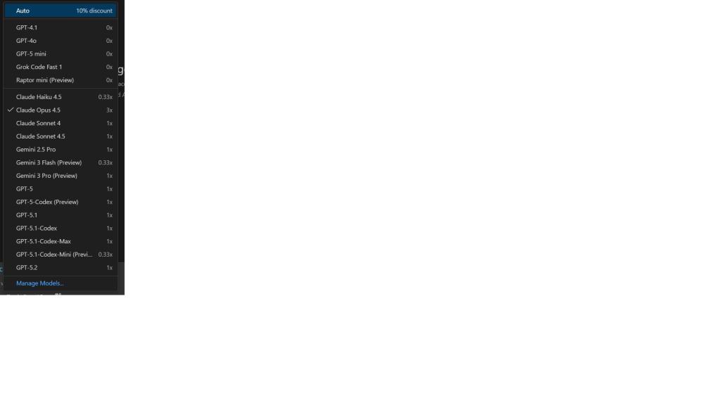

  Quote  I made some progress yesterday with Gemini, but it was often frustrating.
  Quote  but this morning I subscribed to Claude Pro.
I use AI through the Github Copilot Chat plugin to VSCODE. This give me access to a range of models for a single monthly fee. For simple stuff, I use Claude Sonnet or GPT-5.1-Codex-Max. But for the hard stuff Clause Opus 4.5 is miles ahead of the others but consumes budget much faster with a x3 budget ratio.
Edited 2026-01-09 18:43 by matherp

  matherp said  for the hard stuff Claude Opus 4.5 is miles ahead of the others but consumes budget much faster with a x3 budget ratio.
After 6 hours of work and 600 lines of code added yesterday with Opus 4.5, Claude informed me (at about 6:30pm) that I had run through my budget, and the next refill wouldn't occur until 8pm. So I cooked dinner, ate with my wife, and then idled a bit.
I may not have another day quite as intense or productive as yesterday, but if I am sometimes forced to stop and do other things, that's not such a bad outcome.
