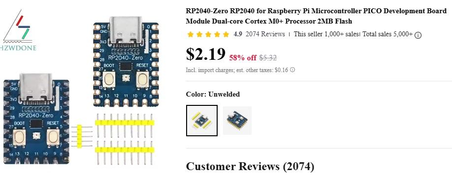

Posted: 11:31pm 03 Jan 2026
  spock57 said  the Picomite is amazing, but for some of my blinky flashy things it's overkill
What do you use that is less overkill than, say, the RP2040-zero for $2.19USD?
Several people have produced PCBs for this module.
CH32V003 0.15 UK pounds bare chip, same chip on basic dev board 0.6 UK pounds I could not fill 2K of ram and 16k of flash in my whole life. The Picromite is great but I feel sort of guilty having so much processing power for fiddling small projects such as mine. My last project ran in 256 bytes of eeprom and was only 4 bit, just for the hell of it I built it, played with it, scrapped it. I'm pushing 70 but have the intellectual capacity and curiosity of a 10 year old, the link below illustrates the point. There must be other nutters like me out here which is why I posted to the forum in the first place

Posted: 09:05am 11 Jan 2026
By all means try one and let us know how you manage with it. :)
However, Tiny Basic is very restrictive and usually (depending on the version) inefficient in memory use. You will find it pretty easy to fill 2K of RAM. As you get better at programming you'll almost certainly want more than Tiny Basic can provide.
MMBasic on the RP2040-Zero would need the following additional parts:
For the keyboard:
PS2 socket
Two resistors
Two Schottky diodes.
For the display:
VGA socket (or a soldered lead made by cutting a VGA lead
Four resistors.
To connect to a PC:
A USB-C lead
With some soldering skills this can be built on stripboard (I have an experimental layout if you are interested but I've not actually built it yet as I need to dig out a VGA lead to cut up!). The layout also includes a micro SD card socket and, if you have a splitter cable, the facility to use a PS2 mouse. It's also possible to do it with a proper level shifter for the PS2. There is stereo audio output and a I2C port for expansion. All in 51mm x 72mm. I've not considered a PCB design for it at the moment as it's intended for people that want to build without one.
This would give you a keyboard interface and a colour VGA text and graphics display. You could load and save programs to the PC, which would also supply power to the board. You may be able to use the monitor for both the setup and as your VGA display.
You can use the BOOT button as a user button input and there is a programmable LED to play with too.  :)
MMBasic has no line numbers - you get a proper full screen editor built in.
LET is optional. Apart from GOTO <line number> and GOSUB <line number> you can program in MMBasic very much as you would in Tiny Basic. MMBasic uses labels instead of line numbers if you want to usee GOTO and GOSUB.
You have two (or three) "flash slots" that you can use for program storage and the "A:" drive where you can store programs and data. Your current program remains in memory even when power is removed - no need to reload it.
Yes, it costs more, but it won't leave you thinking that you've wasted you money on a very low powered system. You also have to bear in mind that the RP2040-Zero includes a voltage regulator and USB interface to your PC. There is no need for special hardware or software programming tools.
Having said all that (which was rather a lot!) I'm not going to knock mini chip programming. It's great fun and I used to do it at one time. If that's the route you'd prefer then that's no problem. :) I just don't want you to be disappointed, thinking that you can learn general or game programming on systems like that. They are only really intended for small embedded projects. It doesn't cost a lot more to get a big increase in capabilities and IMHO that's worth it.
