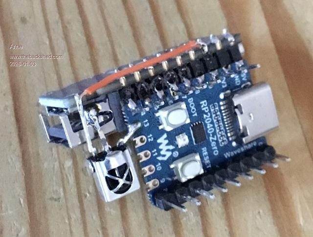

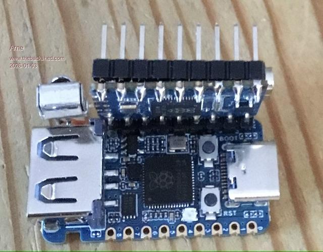

Posted: 10:42am 03 Jan 2026
Hello  Bill,
You can use HID-Remapper on a second pico. It could be adapted/configured to your needs via browser and controlled by MMBasic thru the GPIOs. Here fotos of my actual prototype as IR-Controller.
I actual made some tests to use it as a multi remote control.
Without the second pico you can control the MMBasic editor e.g. with mouse or joystick etc.
See also my post „Picomite & HID-Remapper“.
Arne

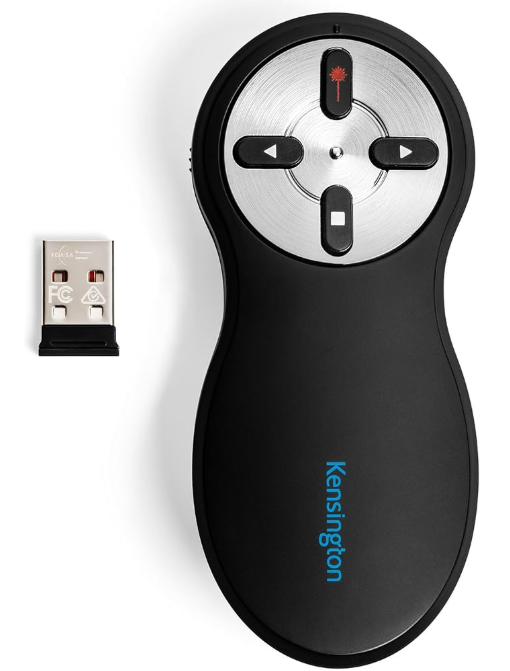

I have a edge case use, which is that I wanted to swap the "blank presentation" button from sending "B" to "W" as I want a white screen not black.  So began my odyssey into all things Bluetooth, HID etc.
Customizable clickers are available which use a little app to customize the buttons - but this needs to run on the host pc, which the "IT GODS" in work wont let me install.  So you need to customize the clicker itself.  None like this were available for less that £60-£70 so I thought I'd have a bash at making one.
How hard could it be?  Microcontroller, BLE stack and a few buttons / charging circuit etc.  So it began.

So, in the end I sort of succeeded and learned a lot.  BUT I eventually bought a £30 "mini" Android smart phone from eBay.  One of these:
And used free software from the PlayStore to make a far more functional part that I can customise exactly what it sends etc.
My "hacked together" version cost about £30, this phone £35 -- so I suppose I could have just bought an expensive clicker in the first place, but where's the fun in that.
